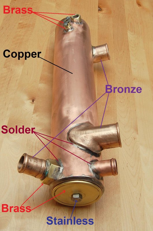

The heat exchanger is copper but I am sure that it has other metals in the mix. I will look for some acetic or phosphoric acid.
Dissimilar metal (credit Maine Sail Marine How To.)
