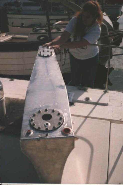

But, the first option if the tank you have has no leaks, would be to install a ready made clean-out port. They make and sell them in different sizes. Well worth the cost.
I open our front one (we have 2) and inspect the tank about once a year or so.
I also put our pickup and qty. sending unit in the clean out plate. If I ever need a new qty. sender, I can simply replace the low cost plate.

If the tank is aluminum and it's never been cleaned, you're living on borrowed time. Order and install an access plate. I got mine from Seabuilt, but I'm not sure if they're still around because their website isn't working at the moment. Anyway, water accumulates in fuel, algae lives in the water, and forms a slime layer on the tank interior, secreting an acid that eats aluminum. When we pulled the aluminum fuel tank on our '95 H336 a few years ago and opened it up, the walls were covered with a scaly crud. When I scrapped it off, it revealed hundreds of pinholes that had almost perforated the tank. I had to take it to a welder to have a new bottom welded in. Just do it.
