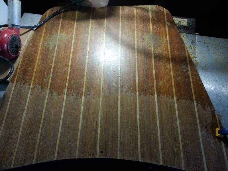

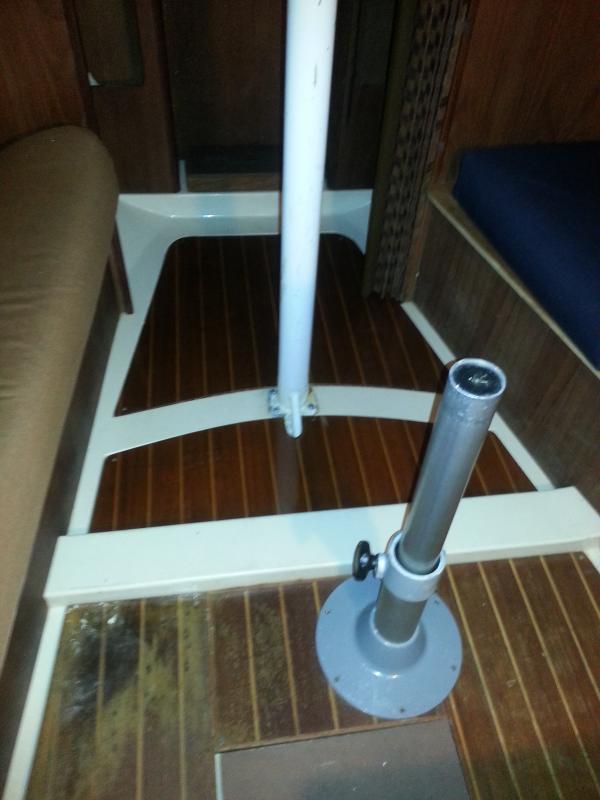

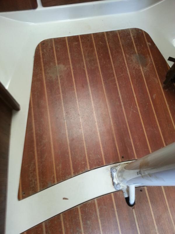

I am refinishing my 88 Hunter 30 floor right now/this winter. I did not sand them down, I used a heat gun and scrapped the old varnish off, then very lightly sanded and cleaned with de-natured alcohol. Then applied about 4 coats of Sikkens (which does not require re-sanding after each coat), then a single coat of Epifanes clear varnish (1 can of each should do you). Using the heat gun takes a while, as it heats the varnish and loosen/melts it enough to scrape off, its not like melting butter, but it does come off. Check out You Tube for different methods on how to refinish your floor. The Pics are a few of my before/after shots. My boards are still in my house waiting for spring before I install them for good. Hope this helps.

They look terrific KB.... Inspires me to try that on mine.....
However, I was on the boat this weekend.... A tad bit cold and getting colder each day, as it is 6 degrees outside my house right now. One of the floors boards on the starboard side near the galley appeared to be rotted through. Was too chilly to spend time really examining it thoroughly, plus I wanted to get back home in time for the football games.... But seeing that rot, I am not sure I will try to bring it back up to snuff or just go ahead with the plasteak. Am going to wait for warmer weather or until I have enough time between travels to spend more than an hour on board and do a thorough inspection....
