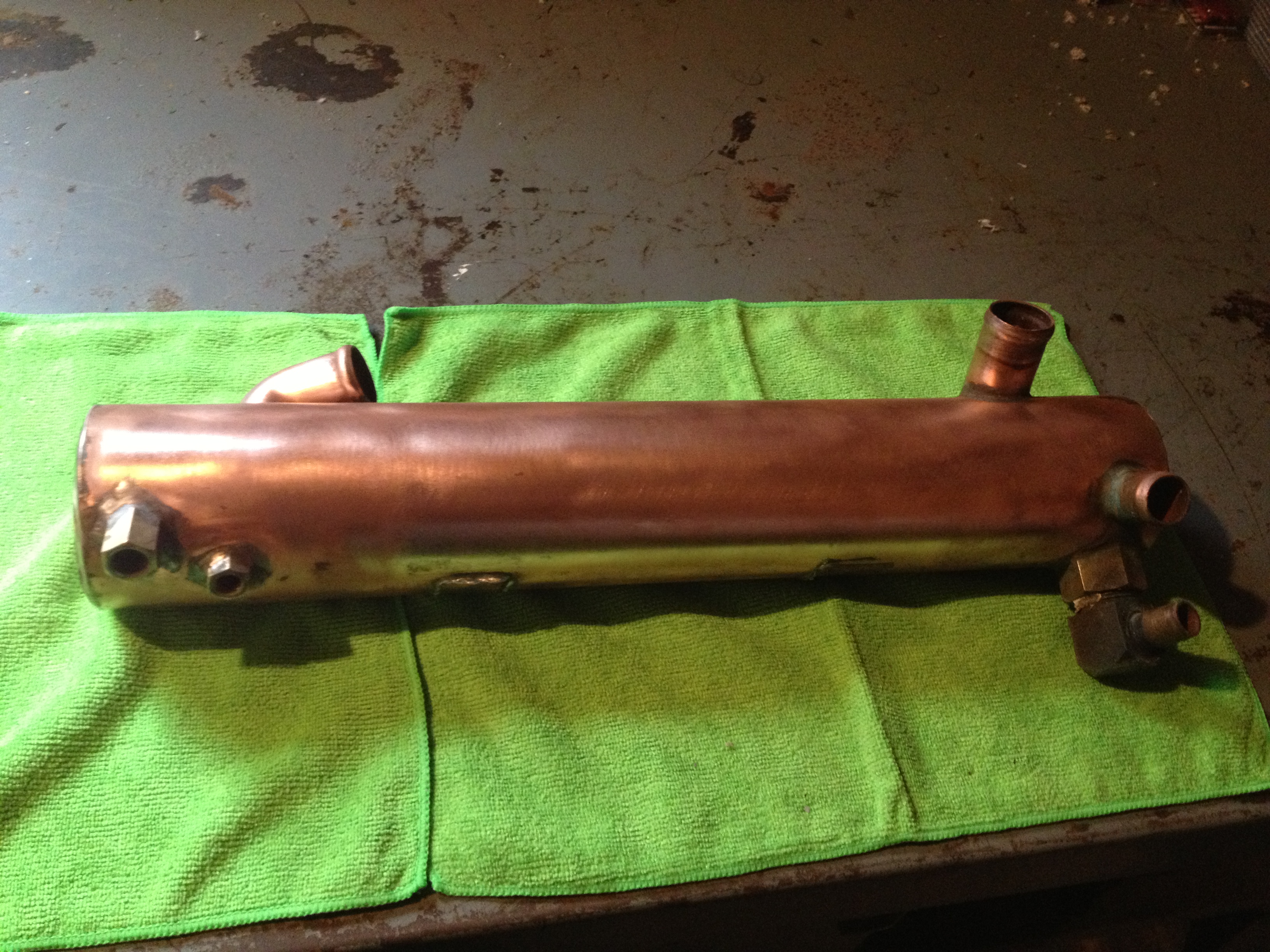

I just used a maroon scotch-brite pads. For the harder to reach areas/little crevices I used the dremel with the buffing wheel or SS brush.
Here is my heat exchanger cleaned that way.
I did my raw water strainer too but can't seem to find any pics at the moment.

I just used a maroon scotch-brite pads. For the harder to reach areas/little crevices I used the dremel with the buffing wheel or SS brush. Here is my heat exchanger cleaned that way. I did my raw water strainer too but can't seem to find any pics at the moment. Good luck and fair winds, Jesse
Are you leaving the HX like that?
Just curious; my brackets broke free and it is cleaned up some but 60% paint / 40% copper.
Peter
No, I painted it with the same paint as the engine. That was two years ago. The paint is holding up so far. https://svsmitty.wordpress.com/2013/01/14/engine-cleaning-heat-exchanger-altenator/
