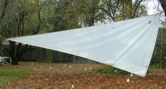

I Cleaned My Jib...
... and it came out great. I had a moderate amount of mildew, but no bugs. On a scale of 1-10 with 1 being the easiest, I would rate the job a 3-4. I soaked the jib in my bath tub overnight with a cup of low sudsing laundry detergent. The next morning I laid it out on the lawn to gently scrub the few area, mostly around seams, that needed extra attention. i then strung it between a couple of trees and rinsed it really well and left it to dry. It looks so good, that now I have to do the main.
