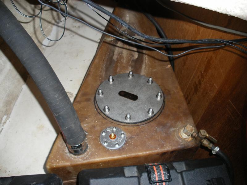

Hi all I saw a post a while back about diesel fuel polishing and had a question on cleaning out my tank. Removing the stainless beast is not an option right now. Do u think a 3 or 4" hole saw will cut thru the top of the tank, and if so is there I can get a ss cover plate and gaskets, any thoughts, oh and I will be using a rightangle drill I only have about 10-12" space in a tight location... Red

Have you considered removing the tank? We have a similar condition and our skippers remove them for cleaning, and can use the sender hole. Once you drill, you'll end up dropping 'bits" into the tank anyway and with your limited access how would you ever get to see inside from your description?

Seabuilt access ports...
I don't work for or sell them, but highly recommend their product for fuel tank installations. Many have tried other solutions but they make these for commercial applications that must pass CG inspections. Mine's (SS one) been installed in a poly tank for over five years without a drop leaked. The price seemed steep, but it's the price of peace of mind to me.

If I use a gasket I can use the aluminum plate wf my ss tank? Tank removal is not an option right now, it a major with Dr. Sawzall....Red

I cut holes in the top of my 35 gallon tank with a 4" hole saw. Buch of nasty stuff in there.
I scraped and cleaned. Then vacuumed (diesel only!) out the tank with a shop vac.
Sealed it up by tapping the tank and sealing it with gasket sealant and star bright plastic covers.
The stainless inspection covers would be better. And they're Coast gaurd approved.
Replaced all filters, ALL fuel lines, cleaned out tank, and then made a 444 nautical mile trip. Engine never missed a beat.
Be sure and put a anti-microbial/herbacide additive when done!
So you won't have to do it again!
Total cost: +-$50.00!
