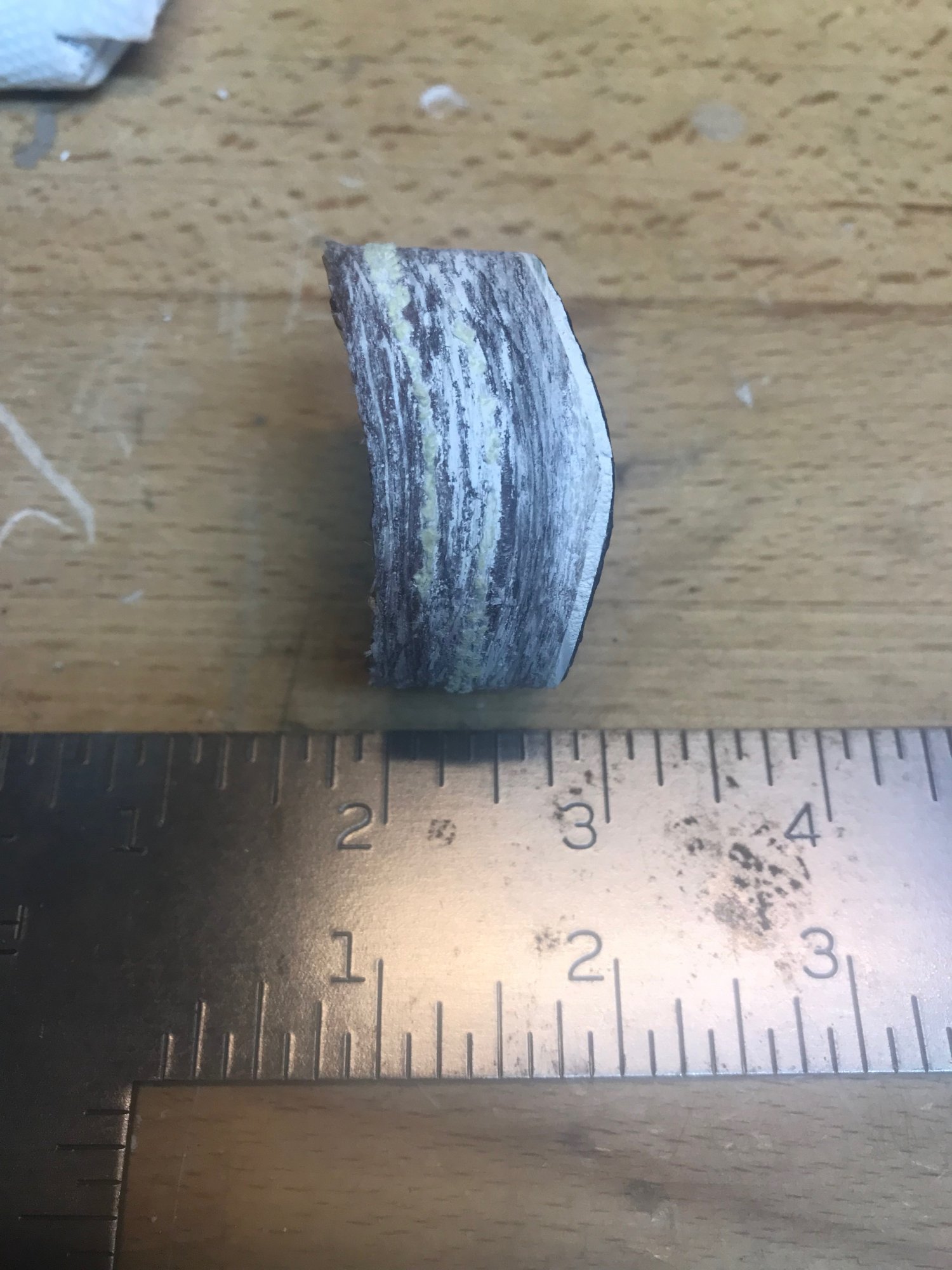

It was an independent installation. There was no "Hunter" installed anything for a thruster on our boat. Here is a pic of the hull plug I took out to install the unit.

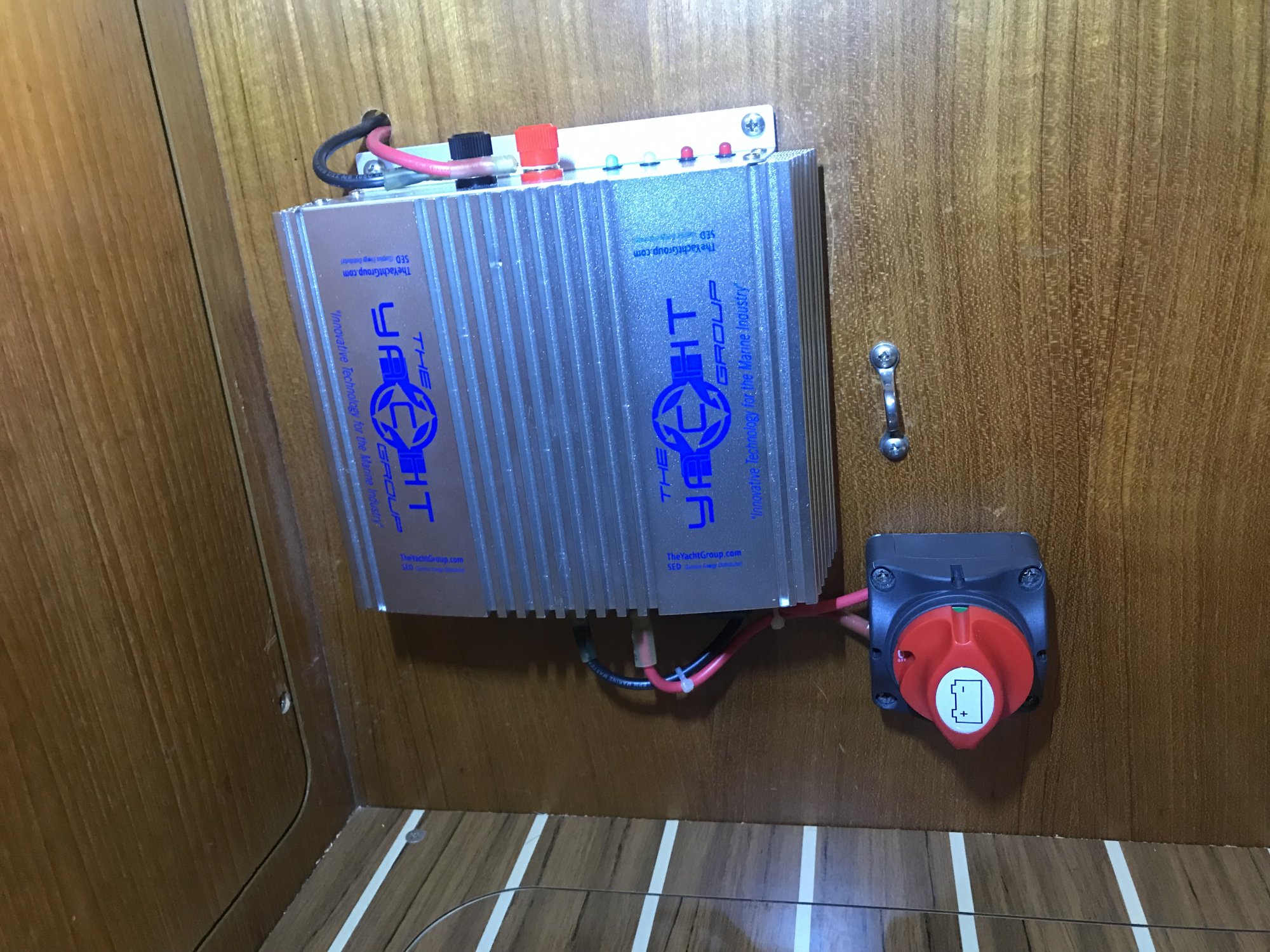

Yes I did install an additional charger for the Thruster Batteries. The Thruster is a 24v system. I have 2 12v batteries dedicated to it. I installed a 12v to 24v charger (which came with the unit) for them.
