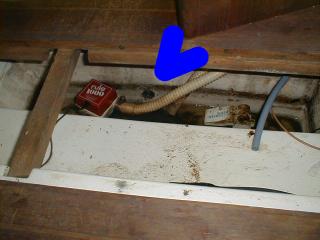

Photo Attached
Here's the way things look now. I'm thinking of drilling a new and larger hole directly below the existing hole you can see in the photo, but just above the very bottom of the bilge. Is this where others have drilled?

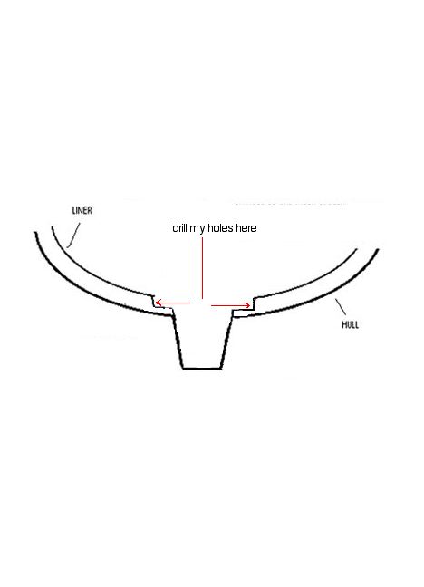

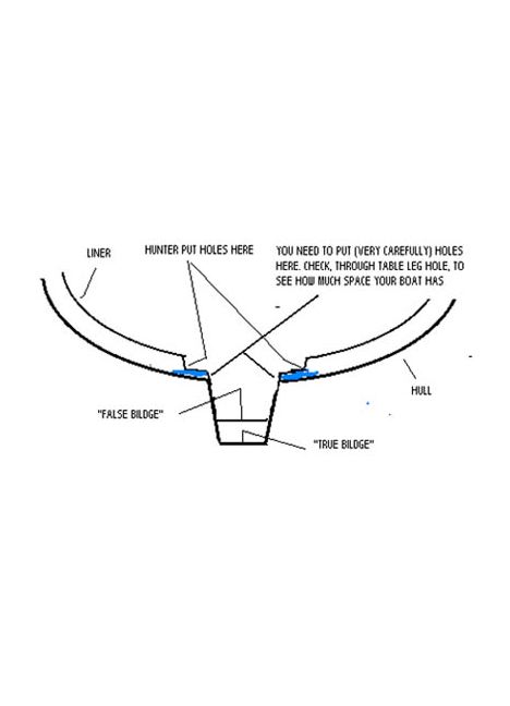

Found This
I found this pict in the 34' forum, that's why I drilled where I did. I don't know for sure if the 31' has a false bilge like the 34' does. Some 34' owners have removed the false bildge floor and reglass it to make it deeper. There is a picture forum it the 34' section. Like I said, I don't know if its the same for the 31'

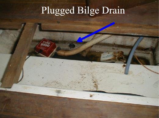

Yes
Steve, that's it. I could of gone lower but I wanted to see how the float switch will be affected. I ran some blue dye water under the V berth and it show up at that hole first, instead of the hole at the false bilge, under the grate, by the engine where it normally would. I also found that there is space around all four side and a little on the bottom of the bilge. Maybe that's why you have that plug there.

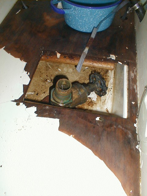

Bilge well under sink
1984 Hunter 31 The area under my sink does not have a drain hole so water collects there. The bulkhead has been removed so that the hot water heater can be replaced. I'll get to the gate value when the boat is pulled next fall. Would you recommend removing the sole and drilling a hole forward or straight down? The bilge area under the steps does not have a drain hole either. Thanks Steve
