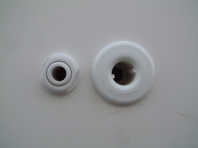

When I converted my vent hose up to 1" diameter, I simply used a 1" thru-hull. I think my original was a straight thru-hull also, but I can't find any old pictures to confirm.
The smaller fitting next to the larger 1" in the picture is my shower sump output.

What good is a bigger hose/fitting if the vent fitting on the tank is 1/2"?
I think a straight through fitting like Rich is showing in his post will probably help nearly as much.

Oh, I forgot to mention that I converted to the larger 1" size when I replaced my holding tank. I had a 1" vent fitting installed in the tank also.
