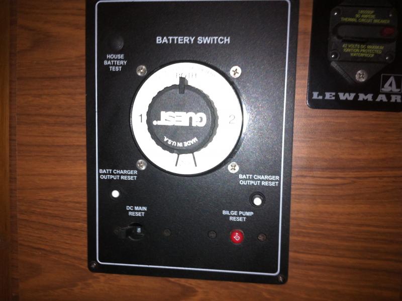

Last week I completed replacing my shore power charger with a 60 amp unit.
The new charger seems to be exceeding the circuit breaker in my battery selector switch when running at full output - so I want to find a 60 amp breaker. The old charger was a pro mariner and hunter installed a 40 amp breaker between the charger and the battery bank.
The cb is as described in this older thread that I found when searching:
http://forums.sbo.sailboatowners.com/archive/index.php/t-65595.html
I could not find the breakers on the SBO store - but I'm sure hunter put these panels as described in the referenced thread in quite a few 356's and 36's.
Do any of you guys know where to get a replacement breaker ?
(Wire size should not be a concern as the run from the charger to the panel is only about 12 inches and it is 8 ag wire. The cables from the panel to the house bank are the big 00 or 0 stuff)

There should be fuses within 7" of the positive battery terminals. MRBF, ANL or Class T type all meet the AIC ratings required. Most breakers do not meet the AIC requirements.
As for the AC circuit breaker, if that is tripping, then the wire must also be made larger. A 15A breaker should not trip on a newer more efficient 60A charger...

Stu - yes the switch and breaker is as you described. I will try to attach a photo. It is the white breaker button on the bottom right (labelled Batt charger output reset) that will pop if the charger is dumping the max 60 Amps into the house bank.
Bob - We had the exact same ProMariner charger in the same location. Mine also goes to the battery selector switch and straight to the house bank - except for that darn breaker included in the selector switch (see photo). The charger does not go thru the 12V panel otherwise on the way to the house bank. I also have the alternator going straight into the house bank and charge the starting battery only via an echo charger.
Maine - yes I have the large fuses (look like 12 ga. shotgun shells) installed right at the house bank - only enough wire before the fuses to handle the bend radius of the 00 cable - less than 7" for sure.
The AC breakers do not trip at all.....no do any of the ones on the 12V panel.....the only breaker tripping is the one shown in the photo on the Battery selector switch.....and the existing one there is 40A - matched to the old charger I suspect.
Which unfortunately brings me back to my original quest to replace it with a 60 Amp breaker.
I found the manufacturer:
http://www.mechprod.com/products/mp-series-16--push-to-reset-circuit-breaker/
But they dont sell to the public. I will contact them....but since hunter put these panels in their boats - I am hoping someone here might have a line on getting one.....Blue Sea seem to have them to fit, but only up to 40 Amps.
Thanks again for the advice and comments !
Paul

My point is the DC output leads of the charger should NOT pass through a breaker. The output leads of the 60A charger should use ANL or MRBF fuses, not a breaker. These fuses should be at least 80A for a 60A charger and within 7" of the battery or the battery positive distribution bus. The wire should be sized to safely handle the 80A+ fuse and not drop too much voltage at 60A..
You can't fuse of use breakers at 100% of their rating. A min of 20% headroom should be included in fuse or breaker sizing.. Thus you can't protect a 60A charger with a 60A fuse or breaker..
Stop looking for this breaker because it should not be there anyway, unless it can meet the AIC requirement and is within 7" of the battery.. Those push button breakers do not meet minimum AIC requirements. I have never seen that style breaker which meets the AIC requirements for a safe installation to a battery..
There are two ways to do this, the right way & Hunters way... Don't forget the green charger chassis ground wire...

As Maine is suggesting - I am not sure why Hunter installed these push button breakers between the charger and the house bank - since the house bank already has the big-ass breakers already mounted right next to the house batteries. It looks like we have the following configuration:
Charger > push button breaker on battery select panel > large 00 wire > large fuses next to house bank > house bank.
The push button breaker seems redundant.
MAINE - what's with the green chassis ground at the charger ? The old charger did not have this connection - just the + and - DC outputs. The new charger has the + and - DC connections - which I have connected, but it also has a chassis ground.........I have not connected this since the old pro mariner charger didn't even have this - is this a critical connection ? There is a green ground on the AC input to the charger - should the chassis on the charger be connected to this ? (The AC input had black white and green - and I just reconnected these to the new charger AC pigtail) ........so should I also then connect the charger chassis ground to the AC green ground ???
