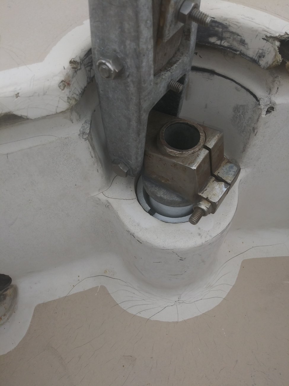

My chrysrler 26 fin keel has a rudder wich moves up and down about an inch. Two separate divers have suggested adding a spacer to hold it in place. Has anyone had this issue?
13,117
My chrysrler 26 fin keel has a rudder wich moves up and down about an inch. Two separate divers have suggested adding a spacer to hold it in place. I'm thinking it's not the original bushings as they are made of pvc pipes. Has anyone had this issue?
Yes, the bearing looks like PVC pipe. Not a good solution. You could add a spacer/washer out of Delrin, however, I would look for a new upper and lower bearing. Try Tides Marine to start, https://www.tidesmarine.com

Thanks for your response I took your advice: found the upper and lower bearings and ordered them.
