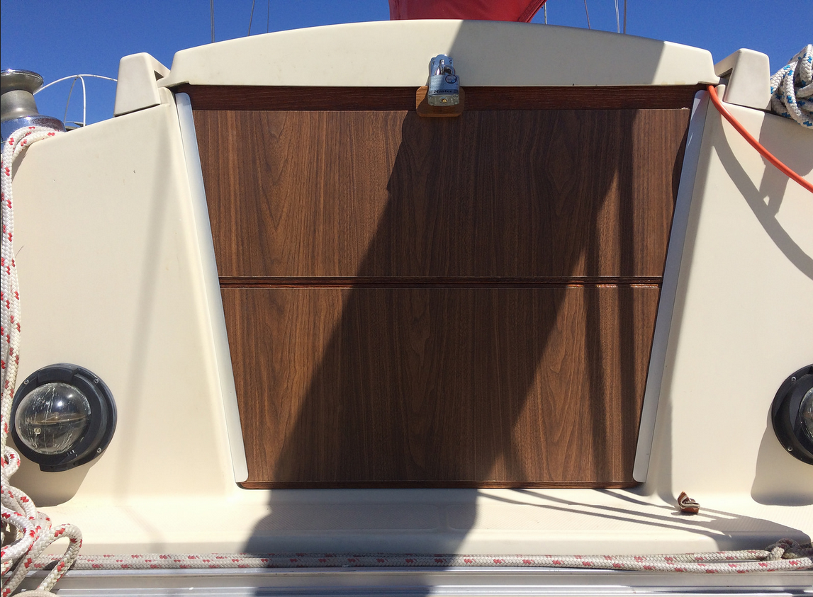

Kampuniform,
Talk to me about how you redid the companionway hatches.
What material did you use?

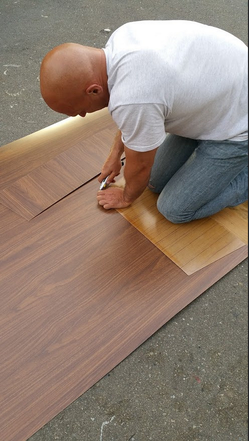

Happily!
I used W305 Parliament Walnut Arborite.
I used contact cement, as it can be reactivated with heat if any problems arise in the future.
I used the old panels to make templates for the new. The old panels needed little encouragement to come off.
One scores Arborite with a sharp knife, then you flex it apart at the seam.
The contact cement was applied to the substrate, and to the Arborite, you wait fifteen minutes for the glue to set-up, then apply your sheet of Arborite to the substrate.
We had record breaking heat this summer, and this fall has been notable wet. The Arborite has performed flawlessly so far, showing no signs of fading, lifting, or peeling.
