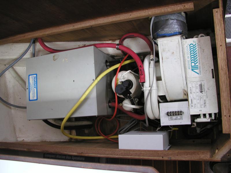

i still have the original 6 gallon Seaward heater that came with the boat in 1985. steel housing.. some rust but in pretty good shape considering. I think that because we never put antifreeze in, nor do we drain them here, they last longer than places where that has to happen. Attached shot is its original location in the stbd aft settee seat, sharing the space with the air conditioner.

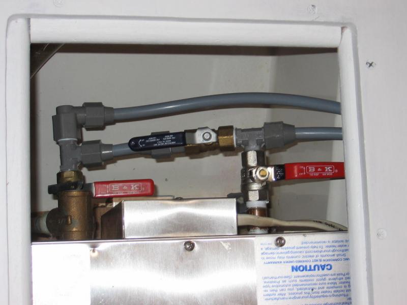

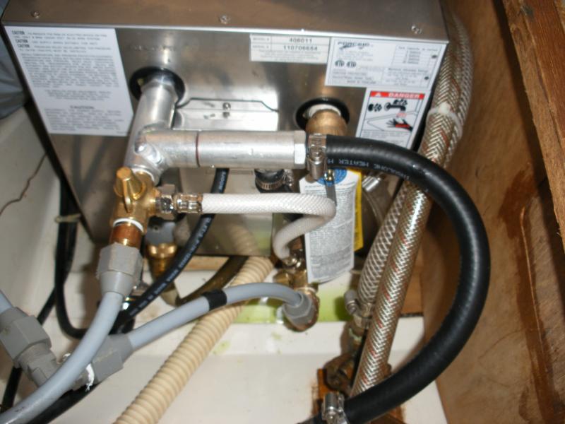

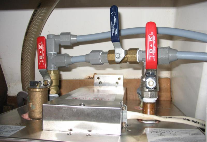

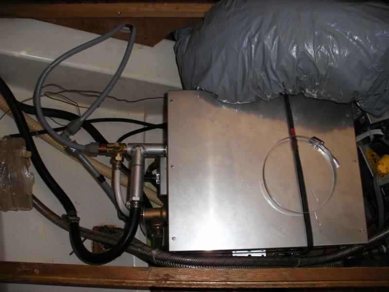

Like Dan I'm on my 3rd unit. Also have switched from Seward to Force 10. going on 7 years on that Force 10. Inlet and outlet for fresh water and inlet & outlet for heat exchanger from engine are on the same side unlike the Seward. It was not a major issue to re-plumb the fresh water around the tank. I re-plumbed the by-pass also but here are pics of how it is set. You'll get the idea that what you are creating is basically a manifold to re-route the water. No antifreeze in my tank either but I can run it through all the water lines and faucets of the boat, hot or cold ! Good luck.
