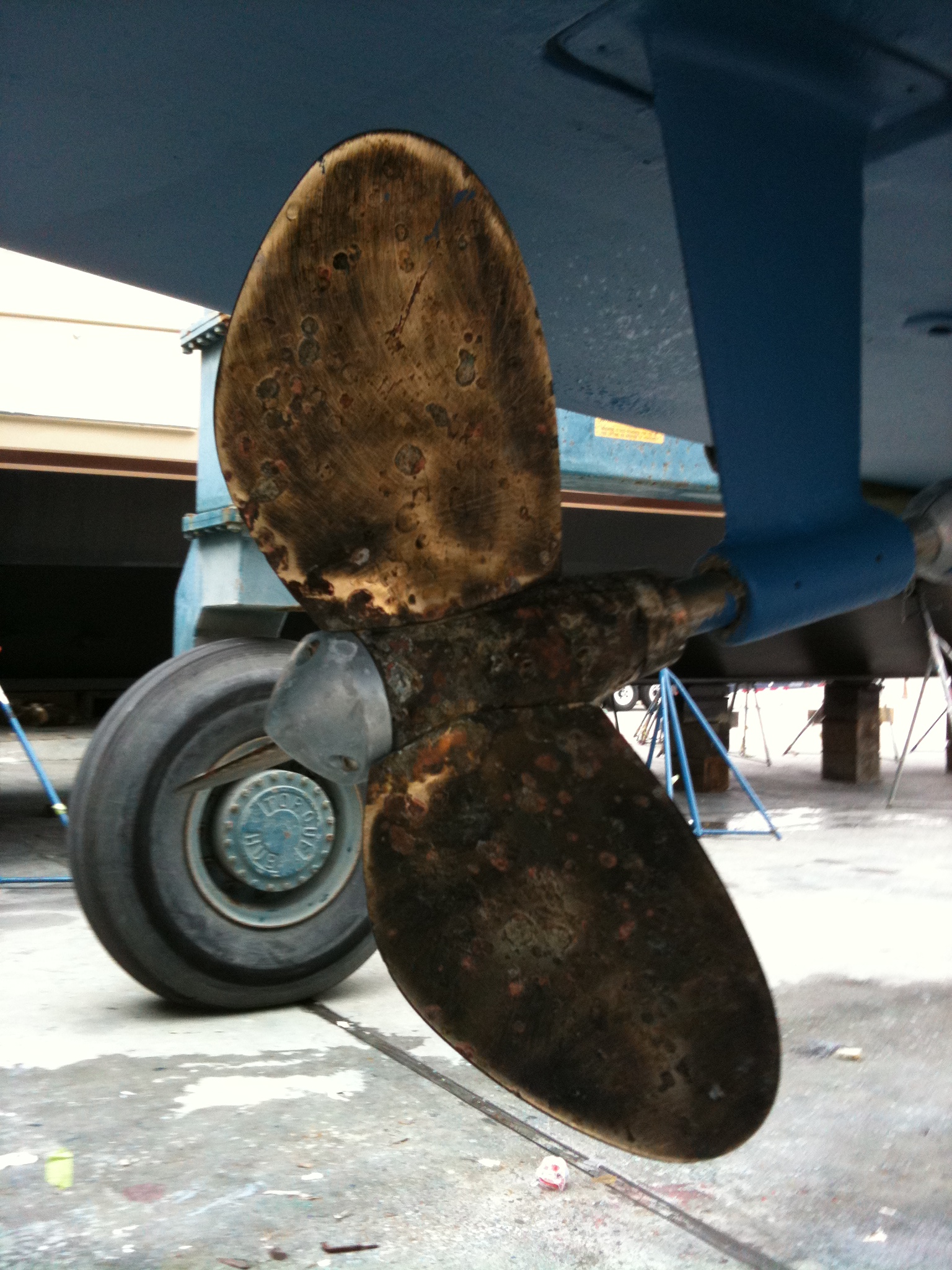

I love the CS Props, but there's a bit of a "tweak": they measure the pitch by the angle of the blades, but since the blades have a bit of "lift" they act like a prop with about 2" more pitch. In other words, a CS 15x9 would load the engine the same as a MW 15x11. They say it's because their props have "more thrust" like it's a Good Thing, but all it really does is confuse people.
That said, I find they work great and have noticably less drag than, say, a MW.
