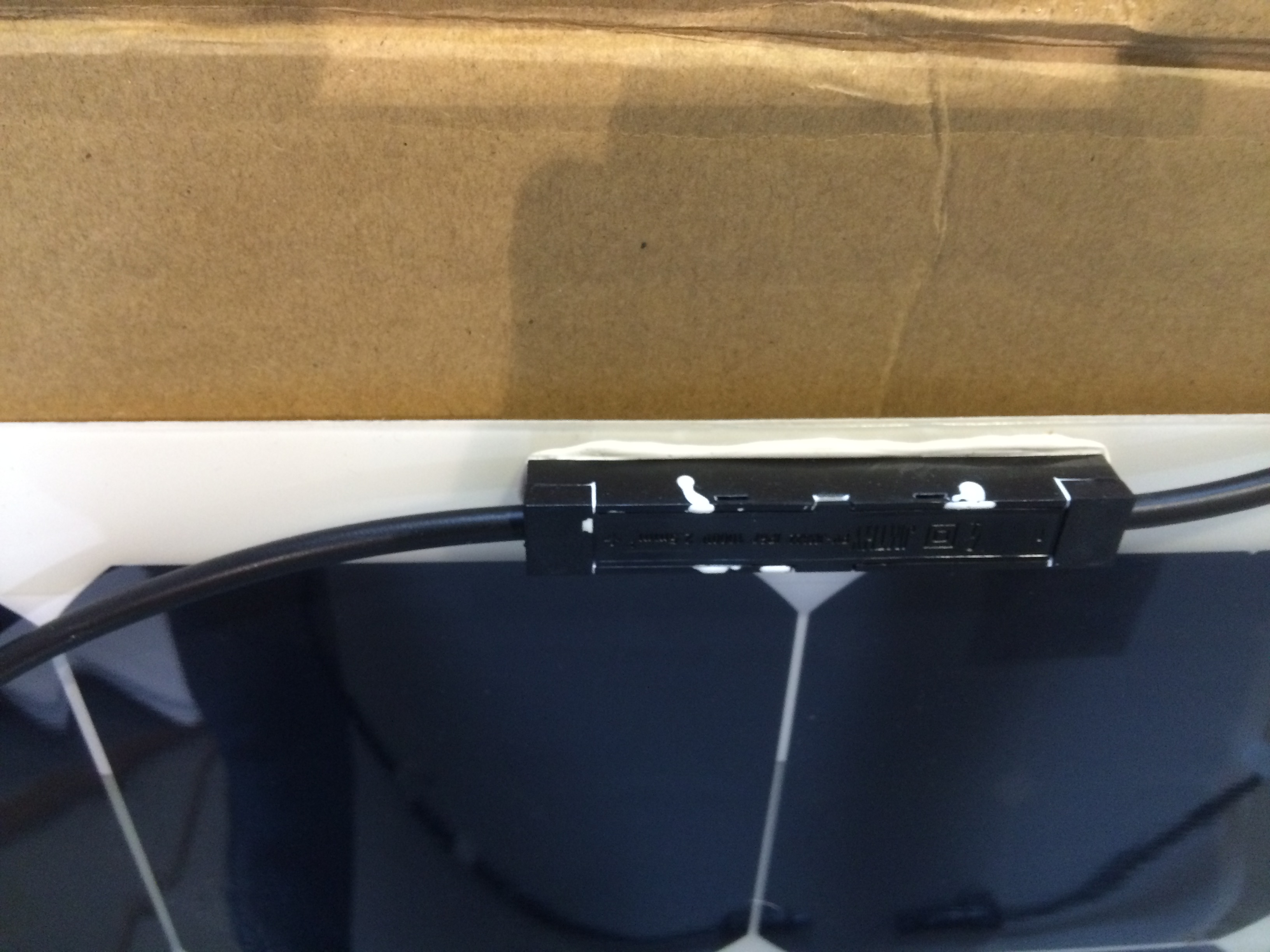

One thing my research pointed to was that testing the panel once you get them is imperative to getting good performance out of the array. On line I have read reports of people ordering two panels and getting one in excellent shape while the other had oxidation and damage. Others had received panels that looked the same but performed very different. So I did a thorough inspection of the panels when I got them. One thing I noticed right off the bat was that the connection on the Renogy panels, compared to the Solbians I had seen at the boat shows, were a little underwhelming. The Solbians have a nice junction box but the Renogy had a cheaper plastic connection filled with sealant to make it waterproof. I like the Solbian approach better but you get what you pay for.
