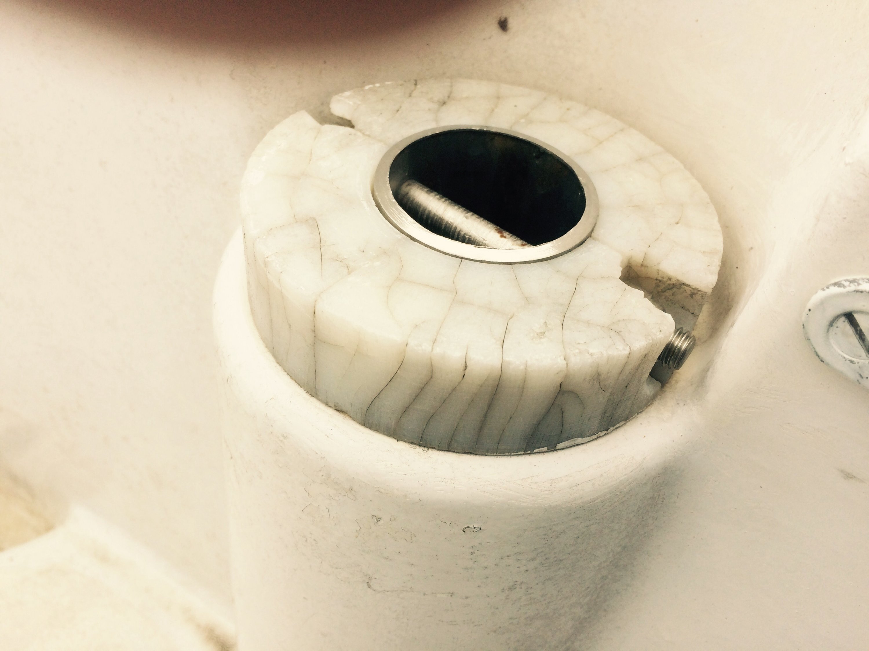

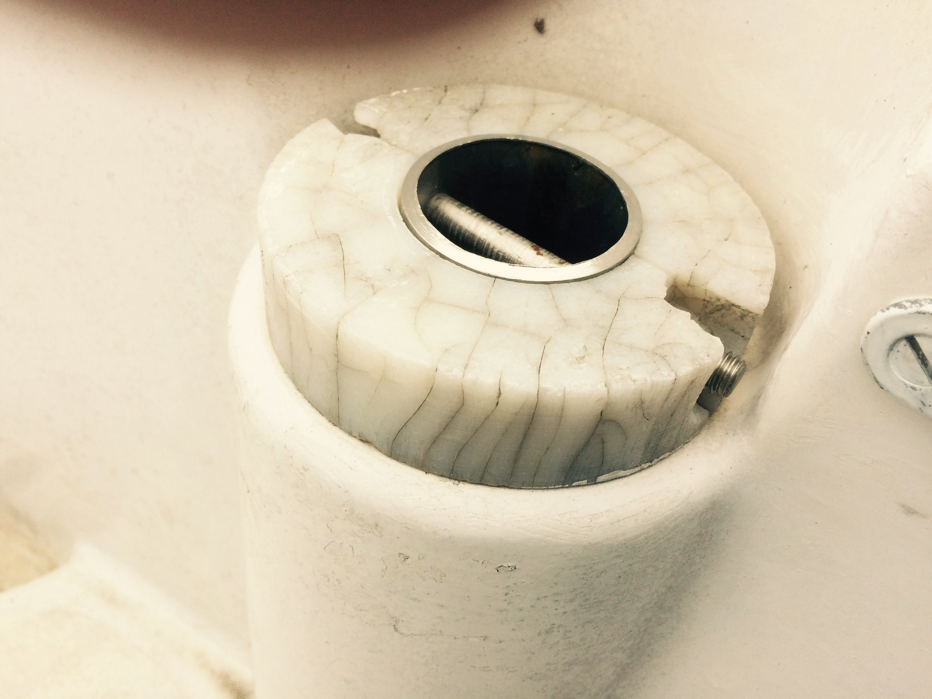

I removed a stack of rotted plywood on my H30 that I am not sure if it was a PO rigged job or a factory install. It was on the top of the rudder post where the emergency tiller would be connected. The rudder post comes up to the bottom of the stern seat within an inch to the access port. It looks like they made 4 12" square pieces of 3/4" plywood with a hole in the middle for the rudder post and slid in one at a time and screwed one to another.....the first piece screwed into the fiberglass seat. The hole has clearance around the rudder post. Just wonder what the heck is this for? That post seems fairly sturdy plus the drilled holes in the plywood had a good amount of clearance around the post.

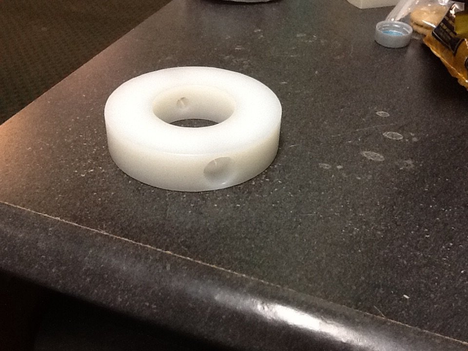

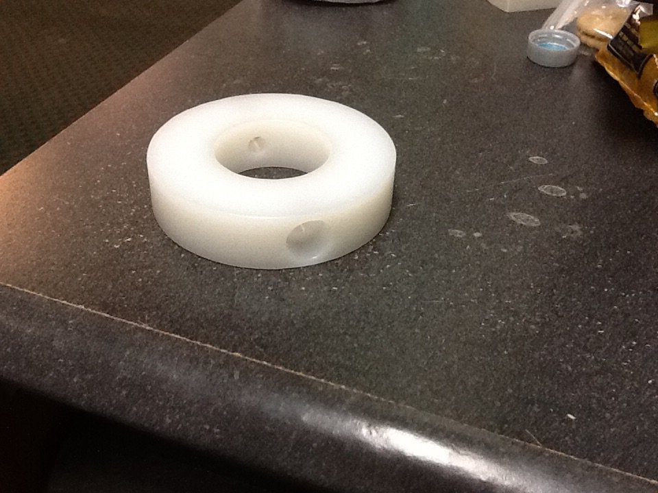

Unless there is a plastic ring with a bolt thrus the diameter and the rudder post underneath the plywood squares, those are what are holding your rudder to your boat. I have a 27' and this is what holds my rudder in. After 35yrs service, it fell to pieces in my hands when I removed it.
I had a replacement made by a local plastics supplier for about $180.
There are no suppliers for this part. You have to have it custom made.

Your description matches mine as factory installed. I guess it was the cheapest way to stabilize the rudder post at its head. Mine suffered some water ingress through the access plate which was caused by the rubber gasket losing seal over time. You can replace the gasket or the entire assembly. But you may want to reinstall your current plate with new sealant. I recommend butyl tape from Compass Marine, Maine Sail's site.

Thanks GGrizzard. I will replace the wood and the access plate seal. I have 2 rolls of MS's butyl tape :) GT, thank you for the pictures. It looks like the 27 had a much better design than the 30 did in this area.
I had a whole bunch of work done on the drive train, so I can't tell you the exact cost, but the guy doing the work also had to fabricate one of these to replace the old cracked one.
