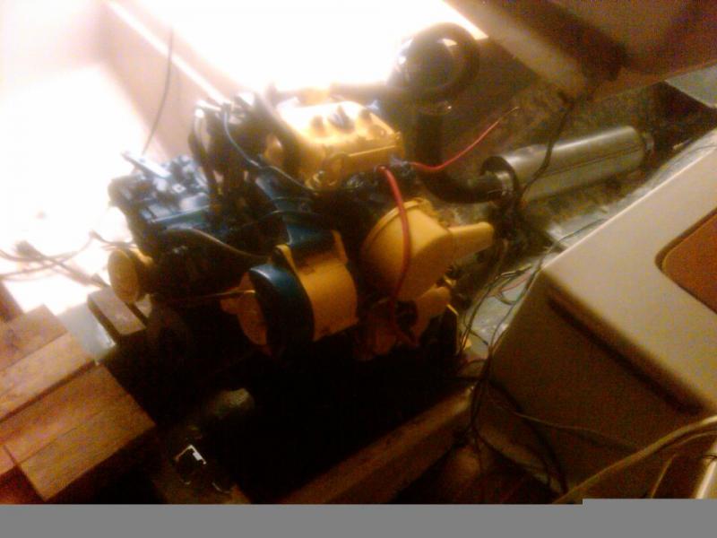

In "Hunter Owner's Mods" under H37C you can see my engine replacement. It includes, I think, my method of pulling the old and heavy 2QM20. Basically I welded a 'C' bracket to go around the companionway so that I could lift it from the center of balance.

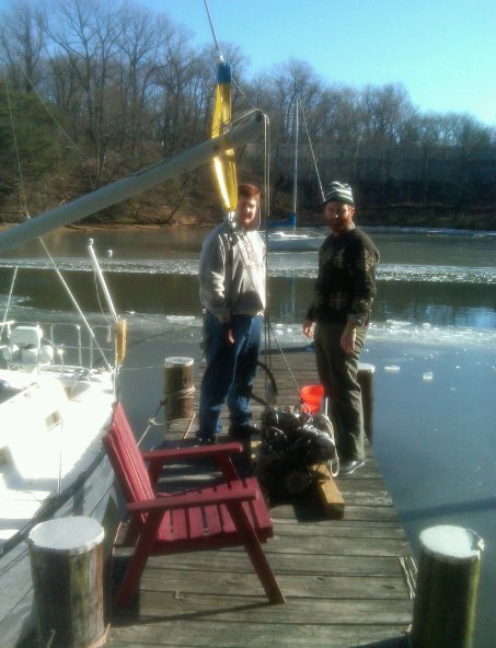

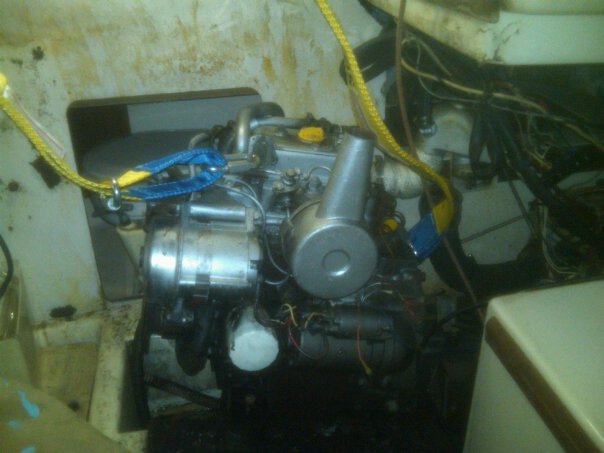

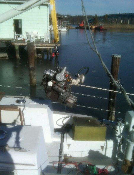

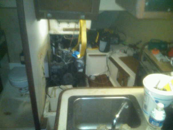

I did this dec' 2010, I first put a scrap 4x4 across the companionway and attached a 1/4 ton mini chain fall bought very cheaply at harbor freight (this is recommended as a large chain fall is a PITA in such small spaces) shackle the engine lift point on the head and transmission. on the way out i had 2 friends control the forward swing as i lifted the engine off the mounts, on the way back in i put a block and tackle horizontally aft from the rear lift point and wrapped a line around the fiberglass bulkhead just forward of the steering quadrant this made the whole operation a lot more controlled i had removed the fuel tank and the shelf it was on because they were both past their prime which isn't a bad idea even if you just clean it well. once the engine was moved directly under the companionway on a scrap piece of 3/4" ply it was re-rigged to the boom with a very strong lifting strap AROUND the boom as to carry all the vertical strain and the boom was used just for leverage and to swing sideways the main halyard was attached to the top of this strap and used to provide the lifting force, once the engine is high enough you can pull it aft sliding farther out on the boom until your clear of the cabin trunk, i then swung the whole rig 90 degrees and lowered onto the dock and rigged a 8' 4x4 to be put over the shoulders of myself and 3 very helpful friends and carried the engine up a very long steep set of stairs and put into a pickup this engine is not even close to 600 lbs. although halfway up the stairs it felt like it. in retrospect i would have removed everything from the main block to decrease weight but also so that it is smaller and without "fragile" pieces that can't be manhandled into position, I'm sorry if that was a bit rambling feel free to ask for any clarification, also i have to original shop manual (necessary) on pdf if you want it.

Do not use the boom. Use the halyard from top of mast and a line from aft end of boom just to control position. My mast was down so I used a build-up of 2 X 4's with a trailer winch bolted on, cable coming down the center. The wood on the hatch slides allows easy movement fore and aft.
Pulling the 2 GM out I separated all removables and took them out one by one, reducing weight to haul up and out. Alternator, trans, water pump. The 3GM was on the floor inside so I just hooked to it, had a friend who happened to show up crank as I guided the engine. (How I got the 3GM on the floor inside is a nuch longer, much more interesting tale.) Dropped it in place three times. Once to see beds were too low, again to mark for holes to drill on the new raised beds, and third time for keeps. Piece of cake. Do not lean on engine while checking alignment.
Do I need to mention that wood cabinetry was unscrewed and set aside, providing a big open work space?

Thanks for the tips and photos everyone! Not sure where I saw the 600lb spec, it did seem unlikely to me but was not sure.
Redbeards yanmar looks new compared to mine :-( I think the lower half of mine sat in salt water for a period of time. Lot of rust and studs / nuts that have no faces on then to remove anything. It still cranks on the first try though....

Redbeard, did you cut a hole in the floor of the companionway access, over the engine?

no i put a folded old towel on the front of the companionway (trim that companionway stair brackets are on) and allowed the cable to make the turn aft. you can just guide is forward as it slips off of the engine mounts, sorry i just looked back and saw how it appears that way from those angles
