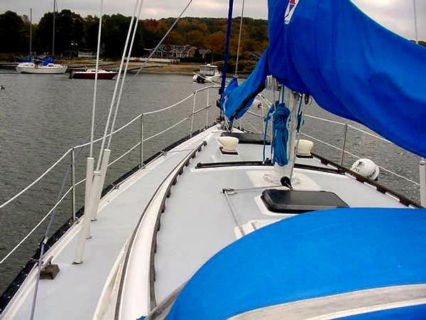

Nice shot of SUNSHINE (soon to be OCEAN ROSE) Ed! This is my first season as the new owner and you can imagine my surprise to see her photo here. I also replaced the main sheet blocks with Garhauer 60 series roller bearing blocks, a triple with cam on the traveller and a double and a single on the boom. With a 6:1 purchase on large sheave roller bearing blocks the main now trims as easy as a sailing dink! Well worth it. I used two blocks on the boom to spread the load, a double block on the original bail and a single on a bail about 6" forward of that. For the second bail I just moved the now unused bail near the gooseneck, being careful to move the internal outhaul block anchor point from the bail bolt to one of the gooseneck bolts. A hook bent on a piece of stiff wire and fished through the center sheave of the gooseneck helps, no need to take the boom apart. The original mainsheet fiddle blocks are now doing duty as a vang, anchored to a 3/8 eye bolt that replached one of the mast collar bolts. As for the cheek block, it now leads the vang line aft to where the mainsheet used to be, you can even use the old mainsheet winch for the vang. Overkill? maybe, but it's there if you need it. The outhaul was also led aft by using a block to the same eybolt and a second cheek block, I had a Ronstan aluminum sheave cheek block about the same size as the old mainsheet cheek block in my junk box for 20 years, knew I would use it some day. If Ronstan still makes it it would be an excellent replacement for the plastic cheek block. Now all of the trim and shape controls are in the cockpit and handy from the wheel, much better when short handed. I'll put some pictures up when I get around to putting film in the camera.
