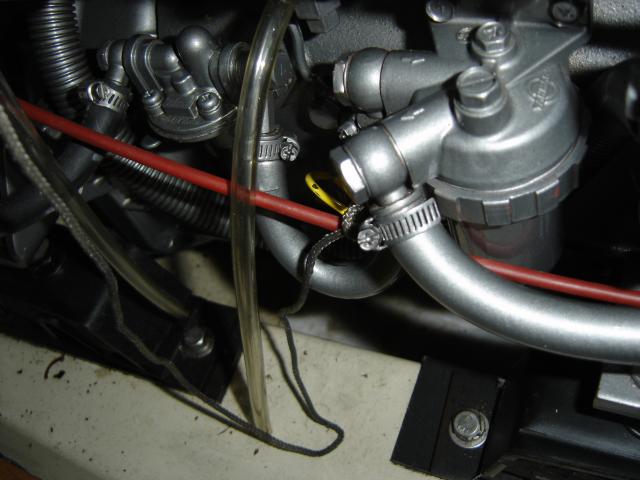

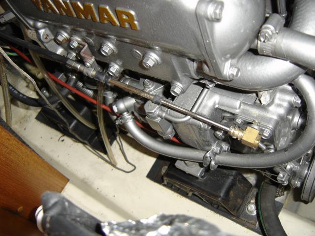

Dipstick Location
Here are three photos of the dipstick. Follow the string to the yellow spot. It is hard to find, once you find it, put a string on it and then you can at least find where it is. REMEMBER where it came out so you can find the spot to put it back in! That is harder than finding it. I feel for the loop in the hose just behind the fuel filter.
Good luck!
