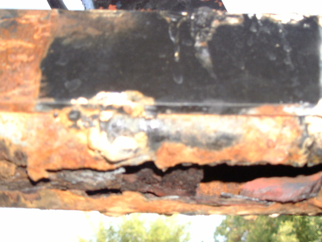

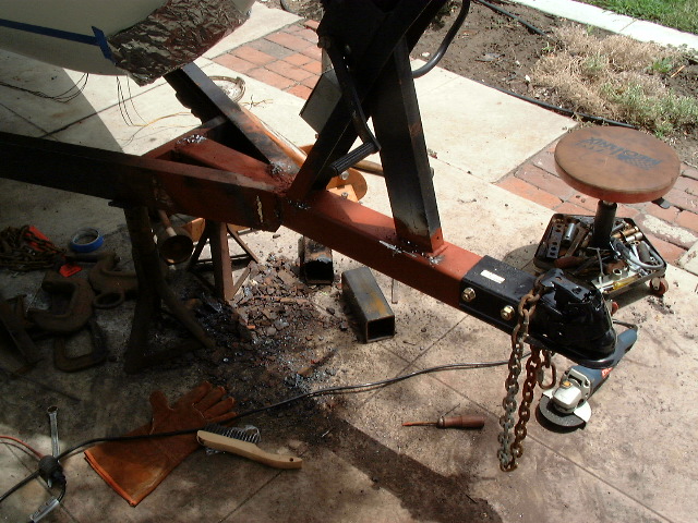

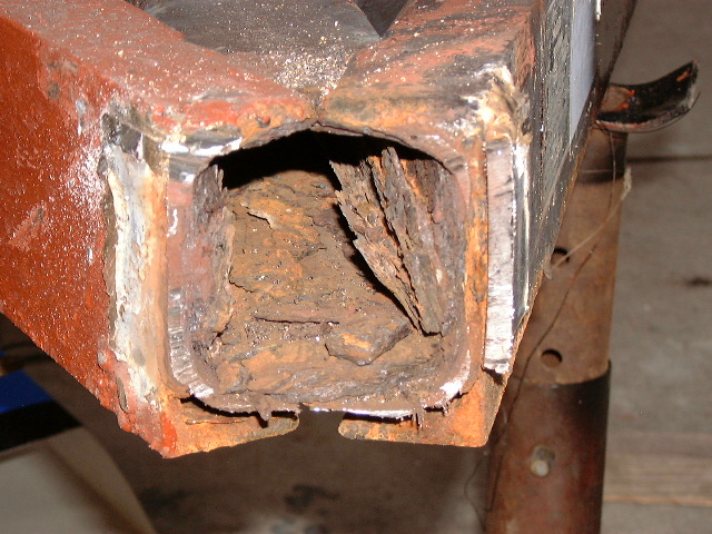

Check the tubes of your trailer as well. This is what I found after towing the boat home for the first time. I decided to paint the trailer and when I got to the tongue I strarted cleaning off the "surface" rust, only to find a small hole under the flaking paint. I probed it with a screw driver and created a 2" hole the full length of the tube on the top and bottom of the 3" square tubing. I had panned on going sailing that weekend but spent it replacing the tongue. Thank goodness I decided to paint it that week because I would have never notice what was (was not) under the paint. I doubt that the boat would have made it to the marina.

Wow! That's nasty! My trailer is galvanized and appears to be in great shape. Sound familiar?

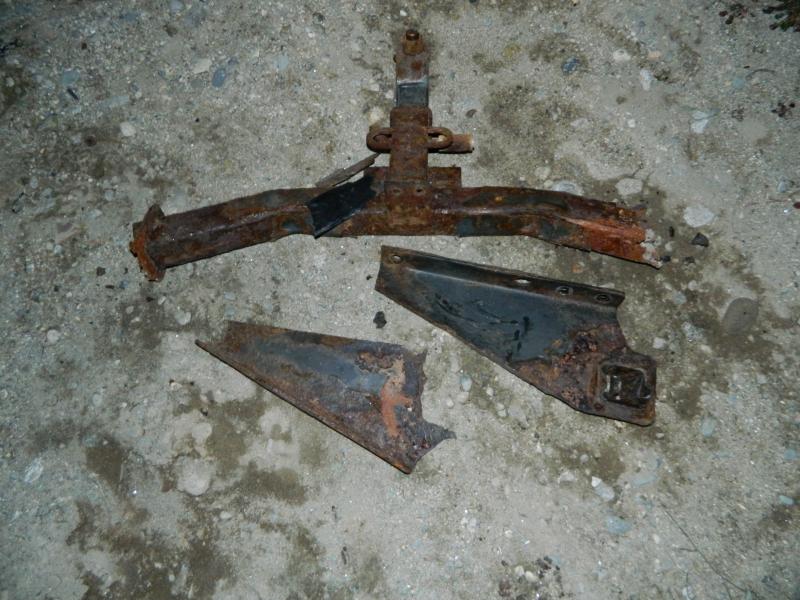

Attached is a photo of the aftermath. Note how much of the steel still has paint on it. It's still thick and looks pretty good. The parts that gave up the ghost are at the welds where the tube passes thru the plate.

You really cannot check welds under paint. Play it safe, chain your receiver hitch to your frame!
