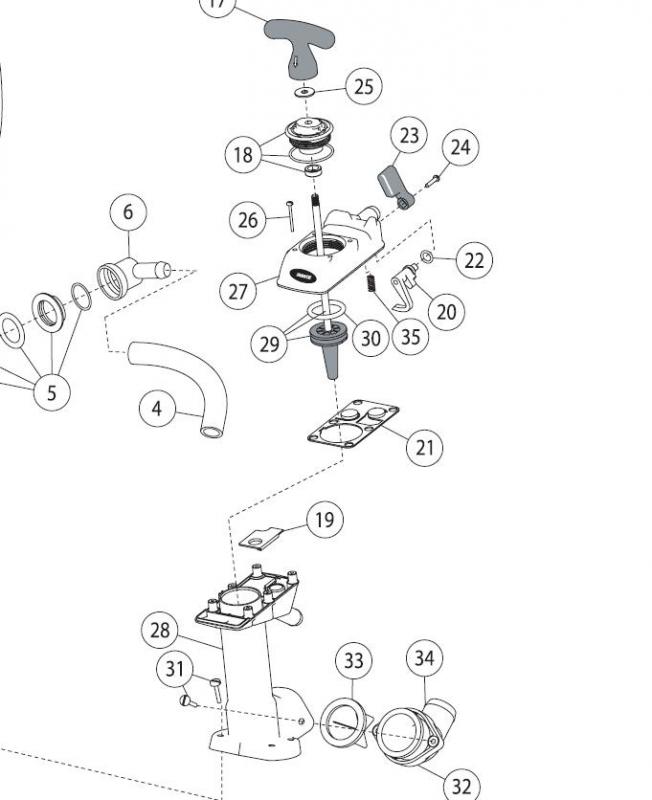

....................... gotta wonder about that one for a Jabsco head, Stu.
If you look at the exploded view of a Jabsco in DRY position, there will always be a couple of inches of water above the piston as it slops back and forth through the forced open discharge valve. As long as you've got any water above the piston, you're not going to get additional wear.
I can attest to this #$@^%>&%*! condition as I always try to remove all water possible from above the piston when I am stuck with removing and lubricating the piston ring. There's always a few inches of water remaining above the piston which manages to spill down the front of your shorts :cussing:.
Removing the piston o-ring to lubricate just it and nothing else is mostly an exercise in futility because it doesn't put enough grease in the pump last more than 15 minutes...you might as well just flush a shot of vegetable oil. If you want a lube job to last a full season AND stay dry while you do it, buy a tube of SuperLube thick Teflon grease, take the top off the pump. Stick the tube nozzle into the pump and give it a healthy squirt. Pump a couple of times to spread it all over the inside of the pump cylinder wall...put the top back on the pump...you're done till next spring.
"As long as you've got any water above the piston, you're not going to get additional wear."
If water were all that's need to keep a pump lubricated and prevent wear, why do pumps need grease?
