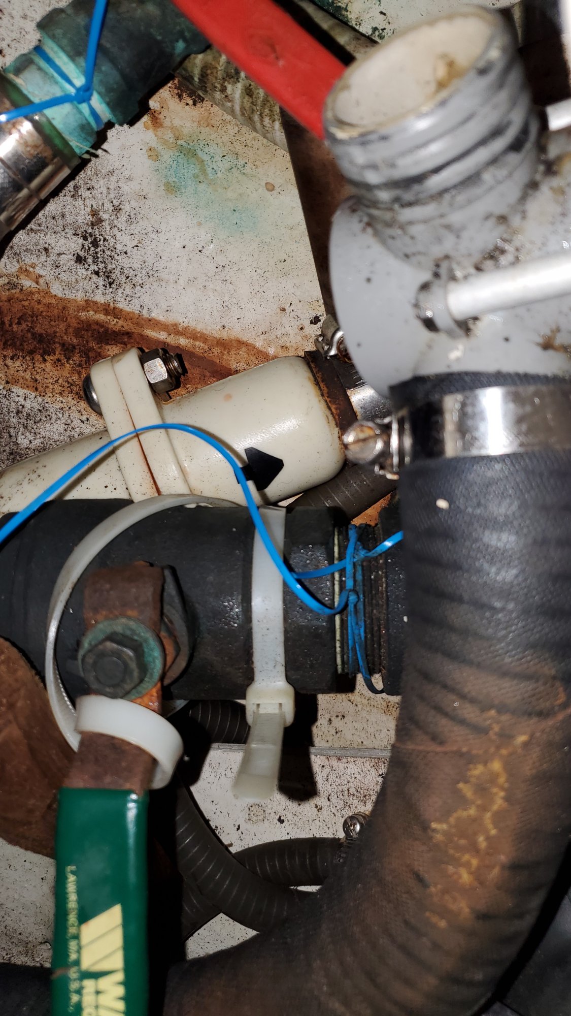

Is a check valve normal/acceptable in the head plumbing? I'm replacing hoses and there's one in the hose from the Jabsco pump to the tank (via a y-valve, but that's for later.)

No...there should not be a check valve before or after the joker valve in any toilet.
And after looking at your photo I'm VERY glad to know you're replacing all the hoses! You WLL be using ONLY sanitation hose, no clear water hose even for the toilet intake or tank vent?

I think the check valve he is referring to is the joker.
10,151
That check in the middle of the picture (with arrow pointing right) looks to be in a small diameter line .. maybe 5/8" ? seawater supply to the toilet pump or a check in the bilge shower sump?
If it is in the tank vent line, there would be a , uuhhh, Shower in the works !
--Peggie
Yes, that's the plan. Not fun. I think they installed the hoses before adding the pan to the hull. Some of them are original. Fortunately the number of major projects is declining.

The clear plastic hoses you see in the photo are are fresh water lines from the tank to the foot pump.
I made good progress today, except for one piece from the y-valve to the tank. There is no way to reach it. It must have been installed before the bulkhead went in. I marked the location and will drill a hole for an inspection port, but that's out of scope for this phase. It WILL be replaced, just not today. Same with the hose from the through-hull to the siphon break. i have no idea how to reach in and undo the clamps. Maybe another inspection port.
