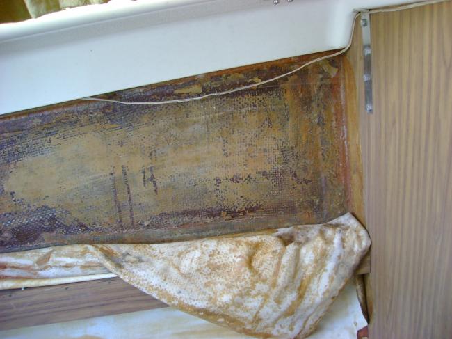

I am looking at a 1975 Oday 25. It needs work and I have been asking you Oday owners about it recently. I have some pictures and want to know what you all think. First some more questions: Are the decks on a 75 O25 solid glass or in there a core? What is the best replacement for the vynal liner? It appears that the pennant is missing for the centerboard how best to replace? The bulkheads seem solid and I think that it need mostly clean up. Any other advise from you O25 owners? Thanks and Merry Christmas Art

Specifically, I don't think the liner is an issue. I have been thinking about ripping mine out and replacing it with something else, maybe marine carpet (Home Depot Grey). I did this in my bass boat several years ago and it was an easy project, and might deaden the sound a bit. Decks on a 25 are balsa cored, check for any cracks or deformation around the mast step and chain plates. I replaced the port bulkhead on my 25 last spring - it was a big job but not beyond the ability of most handy folks. A new centerboard can be ordered from Rudy at D&R Marine, along with the mounting hardware. I currently have mine out in the back of my jeep for repainting, so if you wanted to make one I could send you a template. If you check the archives I posted some pictures on how to remove it. The bulkhead on my boat rotted at the bottom, so hit it with a screwdriver down low, particulatly in the hanging locker and under the board below the head vanity - if it goes through you have rot. Also check for window leaks, as this seems to be common. If you're concerned, a good marine survey should pick up any major faults, although they do miss things. Get references before you pay $$ for a survey. Good luck.

Art, Is the winch for the centerboard pendant line mounted on the table stanchion in the cabin? If so, the original pendant line was a wire cable, but I'm pretty sure that Rudy said that it can be replaced with braid line. You would need to check with him on that. He can set you up with the line and special shackle to go on the winch. The bulkhead looks okay from looking at the picture, as long as it's glass in. If not, you may have to do what I did to my O'Day 222 when I installed O'Day 25 Chainplates to my bulkhead. I beefed up the front side of my bulkhead with oak boards and bolted them to the settees. Even after doing that, I had water leaks coming in from the chainplates. So I had plates welded to each chainplate and used four nuts bolts to each chainplate with backup plates for reinforcement. This cured the problem. My bulkhead was removable. According to Rudy; some of the bulkheads in the O'Day boats weren't glassed in, and this can be a problem with chainplates attached to it. He told me to get it as solid as I could get it so that leaks wouldn't occur. Is there a trailer with this boat? If not, you're going to have to get at the centerboard somehow, either by using a lift or jacking the boat up on the stands like I did, which involves shoring up the stern and bow section to get at the keel. A roller trailer would make this process easier, but both processes can be dangerous. The safest way is to have it lifted at the boatyard, but this poses a question of what condition the centerboard is in. Is the hole in the centerboard where the pendant line attaches, in tact? Is there any damage to the centerboard? You won't know this until you're able to get it down and look at it. This is something that you may want to take up with the owner before you seal the deal. A friend of mine found out that his centerboard had a piece broken on the trailing edge and I'm confident that he can reconstruct the damaged area, himself. He took his board completely off, and has it drying out next to his boiler down his cellar. Outside of that, I sailed a 75 O'Day 25 and it sailed great. They are a great boat. We have one O'Day 26 KC and two O'Day 25 KCs in our yacht club and the owners love them. Good luck, Art!

Art ,you will find a number of Odays of all years and sizes had this type of burlap applied.Our's was the same way when we got it.I peeled it of and scrubbed the old adhesive off.I was surprised that it came off as easy as it did. I took our shop vac down and set it in the cockpit and ran just the suction hose down into the cabin.I was done in about an hour. We picked out a light blueish grey outdoor carpet. The differance it made was unbelieveable.Part of the reason we got our boat for the price we did was that the sagging burlap fabric made the whole inside look shabby. Our bulkheads had been replaced also.We have had our boat for about a year and a half.It handles Lake Michigan very well. I can step the mast by myself even when the boat is on the water.We'll be keeping this one awhile.
