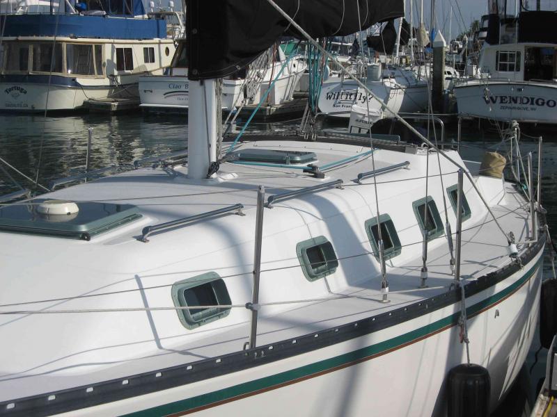

I looked up a picture of a Triton 28. Can't comment on interior grab rails, but for exterior, I expect you are looking to install on the presumably bare forward deck?
For the short span on your boat, I would think that about $100 or less for one stainless steel rail on each port and starboard set-up as in the attached picture would be doable. Tools needed are hacksaw, drill, epoxy, butyl tape or high quality caulk and a screw driver.

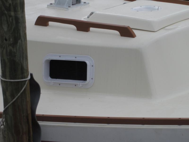

Azek lumber, easy to do with a table saw to rip the board, a band or jig saw to cut out the hoops and a router for the edges.
I went with Azek because it is 100% PVC and the "composites" were using pulp (trash) wood which rotted and mildewed. Sounds like some have fixed this problem.
The pic shows a fwd handrail and Azek toerail. Bedded with Butyl tape.
