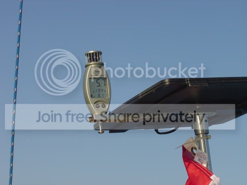

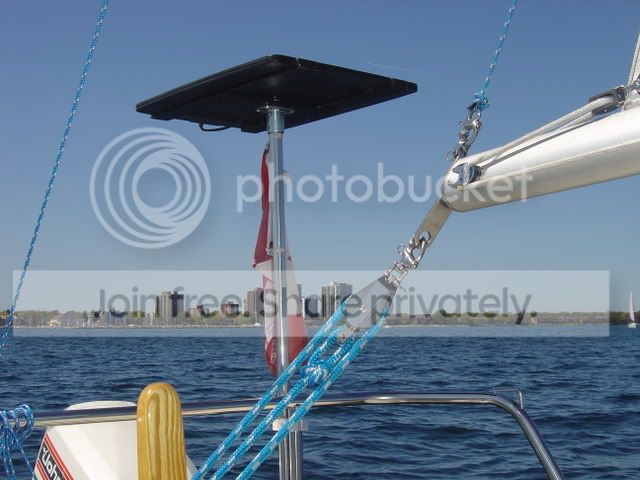

I've used a 5.5 watt panel for a few years and it works great, it keeps my group 24 deep cycle battery fully charged during the week easily. I even use an auto-tiller as well.
Led lights are king too.
The panel comes with wires with clips that lead through the vent direct onto the battery.
I have never had to charge my battery in a sailing season.
I made alum clamps to hold a length of 7/8 SS tube to the pushpit and 1 1/2 x 3/16" alum flat bar under the panel.
