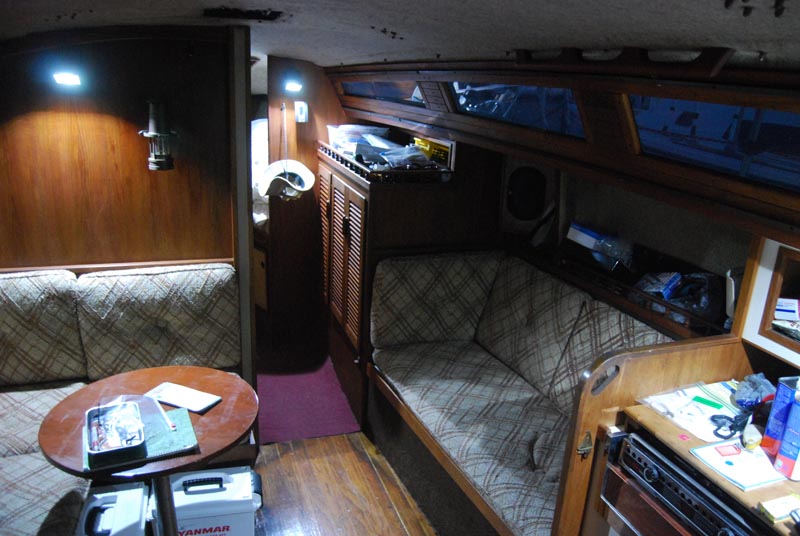

If you take pix of these bulbs, you should keep the shutter speed and aperture on camera the same for all shots. (Manual mode) Otherwise, the camera is going to compensate and it will not be a good test. That goes for white balance also if possible.
Apr 27, 2011
423
S2 9.2A Newport News, VA
I didn't do that initially as I wanted the camera to measure the difference in light output, rather than leaving it to the vagaries of viewing over the Internet, different subjective perceptions, etc. I do think the shots of my hand do give you a pretty good idea of the color balance. I have bought three sockets, though, with the thought of having all three bulbs going in the same shot, perhaps with some text or some such beneath each, so you could get an idea of the relative brightness and color balance. I'll try that the next rainy weekend.

Well...the enclosed Amazon bulbs are pretty dim. I put one in the head, figuring it would be better to have it protected for showering...which is an unlikely activity given no hot water. I put the other in the vee berth for reading, thinking that the warmer dimmer light would be okay there. To provide some sort of rule of thumb...the Amazon sourced enclosed bulbs are probably less than half as bright as the ebay bulbs. They really aren't good enough to use in the main cabin, but are okay in a more enclosed space like the vee berth.
Two thumbs up on the ebay bulbs. Very bright. Light is definitely cooler but pure white not really that annoying blue white of cheap LEDs. The one thing I need to do is to refurbish the reflectors inside the fixtures, as some are pretty rusty / nasty, which hurts output. Eastwood makes an almost chrome spray paint that is good to 300F for $25, which I think I will try to refurbish the reflectors.
If I were to do it again, I wouldn't bother with them, except for head use or if corrosion really proves to be an issue with the ebay bulbs. Even then, they are cheap enough that changing one now and then wouldn't stop me from using them.
Definitely a worthwhile improvement so I don't have to worry as much about battery drain. I will try to take some photos when I visit the boat next. :D
