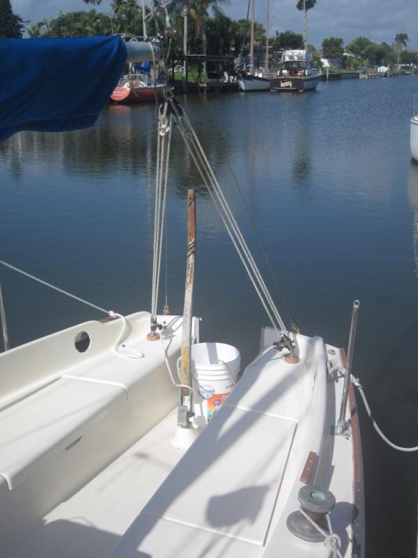

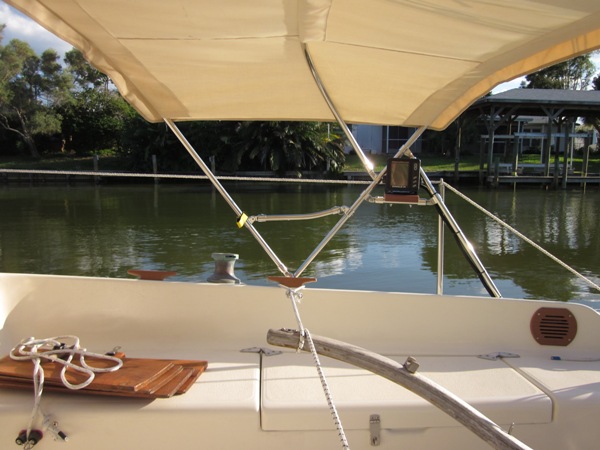

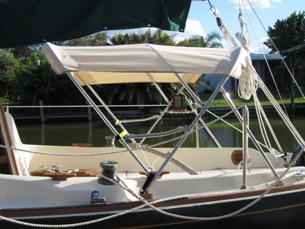

I really needed some shade for my 9.2A, as she came with neither bimini nor dodger. Given the space limitations due to the traveler, I wanted something cheap enough that I wouldn't be devastated if it didn't work out.
I found a 7/8th inch SS framed, six-foot bimini on ebay for $259, shipped. It's 84 inches wide and 46 inches high. I am about 5' 10" and can easily stand upright under it.
Here's the title of the one I bought: STAINLESS STEEL Bimini Top Boat Cover BLUE 79" - 84" W I don't see that size listed today, but if you email the guy, he'd probably get one for you.
Anyhow, I have it temporarily mounted using outdoor, double-sided tape on the pivots, ran the webbed straps forward to the hand holds, and replaced the rear tubes with bungies. It may be a bit far forward as it now sits, but it is really a big help in the shade department, particularly in keeping the sun from blazing down the companionway into the salon. Anyhow, no holes have yet been drilled, so I can relocate it if needed.
Should be finally sailing Karma from Deal Island to home, in Newport News, VA, next week. I'll let you know how the bimini works out under way.
