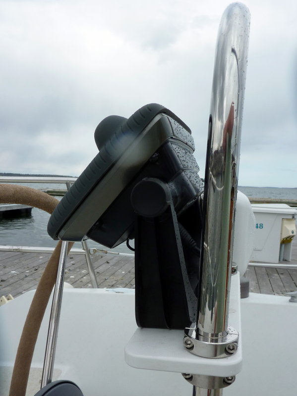

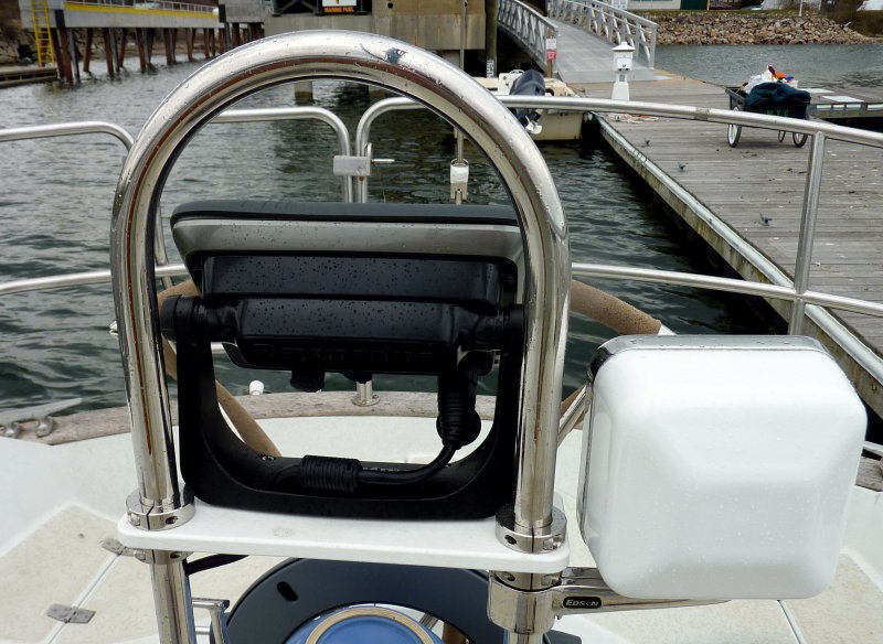

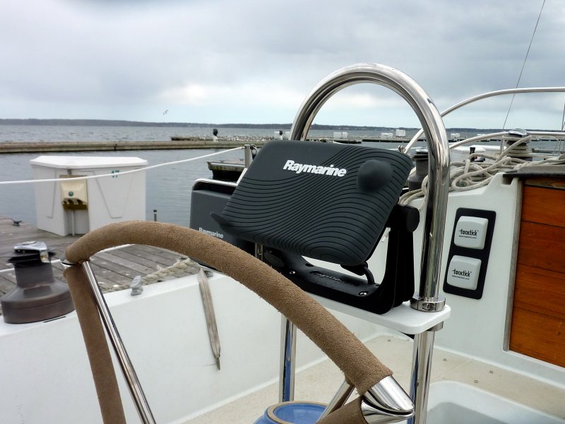

I just installed a new Raymarine e7 and Raymarine AP last week on a brand new Edson pedestal. Owner wanted to stick with a straight guard and this meant no NavPod for the e7 or the screen would be tough to see.
This is my latest bracket design for electronics/plotter mounting. Easy to make, costs a lot less money than one from Edson and it looks professional or factory made.
The secret ingredient I came up with are the stainless clamp collars from McMaster-Carr. I have been using these on PSS seals for a looong time (PYI got the idea from me and they now sell them too). The collars are relatively inexpensive. The 304 versions can be polished well and they hold up well once polished. The 316 versions are more expensive but don't need to be polished as much.
All you do is drill two holes in some Starboard with the diameter and hole centers of your pedestal guard. Then cut your mount to your desired shape, you could also add cup holders etc.. Then just slide it onto the guard and position it with a clamp collar on top and bottom.
