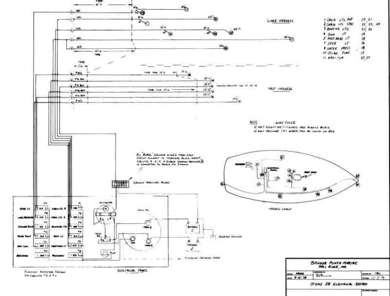

I enclosed the schematic that shows the wiring to the starter.

I would be surprised if the factory wiring were 1GA. Some of them were 4GA. I just did an O'day 30 this past fall that had 4 GA wire, she now has 1/0 wire. It looked factory but on a early 80's boat who knows...
With small battery wire you are adding the wires voltage drop ON TOP OF the normal voltage dip that occurs with starting the engine.
If everything was perfect and your batteries dipped to 11V you'd likely be fine. But if your batts dip to 10.8V AND you have a large voltage drop of say 0.6V your instruments are now seeing 10.2V which may be below the drop out. Many cut out at 10.5V..
For example if you had a battery circuit that was 14' in total length, not uncommon, and 4 GA wire and a 300A in-rush from your Beta for starting, you'd be dropping an additional 1.1V from just the wire. This is on-top of the normal dip a battery bank has when starting.
If you had 2/0 wire in the same circuit your dropping roughly 0.33V... Sometimes that 0.75V difference is what will keep a device on or let it drop out. If you have 1 GA wire then check all your connections. If you have 4GA or 2GA wire you may be better to start the motor with the instruments off...
We still need to know if you are trying to use just ONE battery to start or both. If just one that is just a fact of life the way it is currently wired. If two then we have things we may be able to do.
Still, as mentioned, the easiest fix is to turn the instruments on after you start the motor.

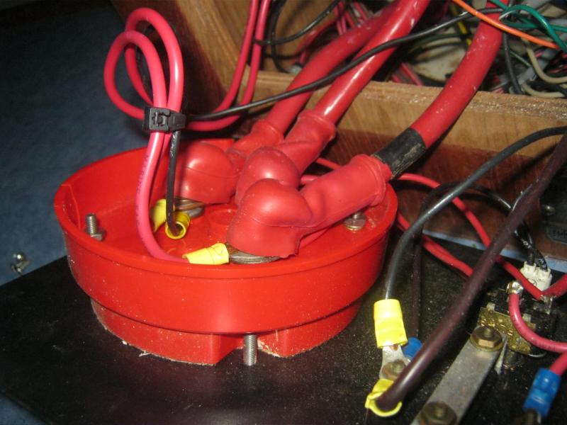

battery switch pics
I looked at the schematic and the picture attached closer and I see that both #1 and #2 batteries positive cables go to the Perko switch.
Which ever batt I select is the one that will provide cranking current for the engine as well as the rest of the devices on the DC bus, which is my issue here.
The pic shows the two battery cables secured to the switch coming from the batts, looks like pretty big cables to me, what do you think? 1 AWG?
(the 2 smaller red wires are from the Promariner Protechi 20 amp battery charger to provide charging )
The grounds cables connect across both Neg posts of the batts and go to ground at what I think is the engine mount.
If you're trying to start off a single group 24 deep cycle voltage drop is just a fact of life. With two you should be able to do it, but, still easier to power up the instruments after starting or use a dedicated "start" battery.
A single group 24 as a house bank is SMALL!!!! If you ever overnight you'll have about 25 usable amp hours, which is not a lot. You might consider combining those batteries into one bank and finding a spot for a new starter battery..?

Sorry about that. Still does not change much from post#8 except for maybe 5-8Ah's more capacity. A single group 27 will likely still drop your electronics but two should do it.
As has been said simply start the motor then fire up the electronics, use BOTH or wire one battery as a dedicated starter....
