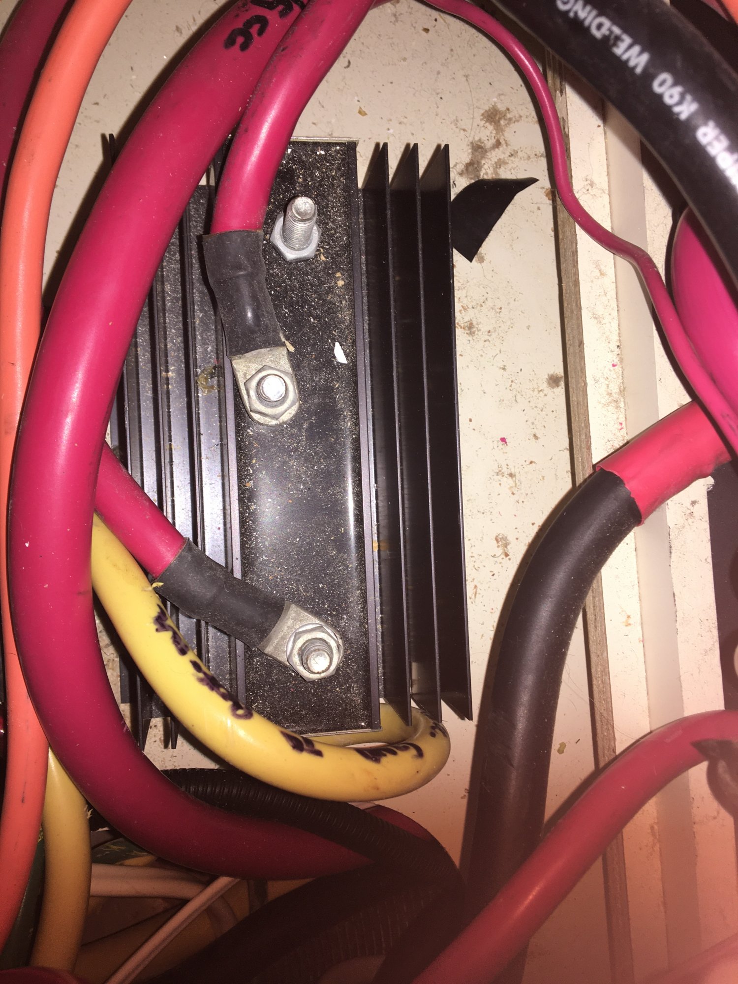

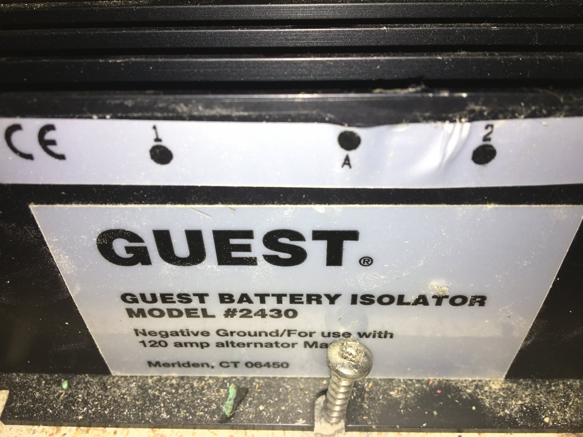

I have located the Guest battery isolator behind the main 12V circuit panel. It is model 2430, apparently no longer made. The battery isolator has 3 pins on the top, ordered 1, A and 2. A photo is attached.
There is no direct cable from the alternator to the battery isolator. Rather, the cable from the alternator goes to the starter motor then it runs to the starter battery on/off switch. (There are also cables running to the generator, irrelevant for current purposes.) On the other side of that switch the + goes to the starter battery itself and it is from that side of the switch that a cable goes to the battery isolator.
On top of the battery isolator, the cable from the starter motor/starter battery goes to the pin numbered 1. The house cable goes to the pin labelled A. There is nothing attached to the third pin numbered 2. Photo attached.

There is a one volt or so drop across the isolator. Your voltage regulator senses voltage at the alternator, the batteries get one volt less and do not charge. If your terror has a vintage sense wire, you can connect this to the house side of the alternator. The alternator will then put out 15 volts to deliver 14 to the battery. Another option more commonly used is to run the alternator output direct to the house battery and swap the isolator for an ACR or combining relay. The ACR will then charge the start battery. Limiting factor here is the distance to the battery, if you don't use heavy enough cable you could lose more voltage than through the isolator.
