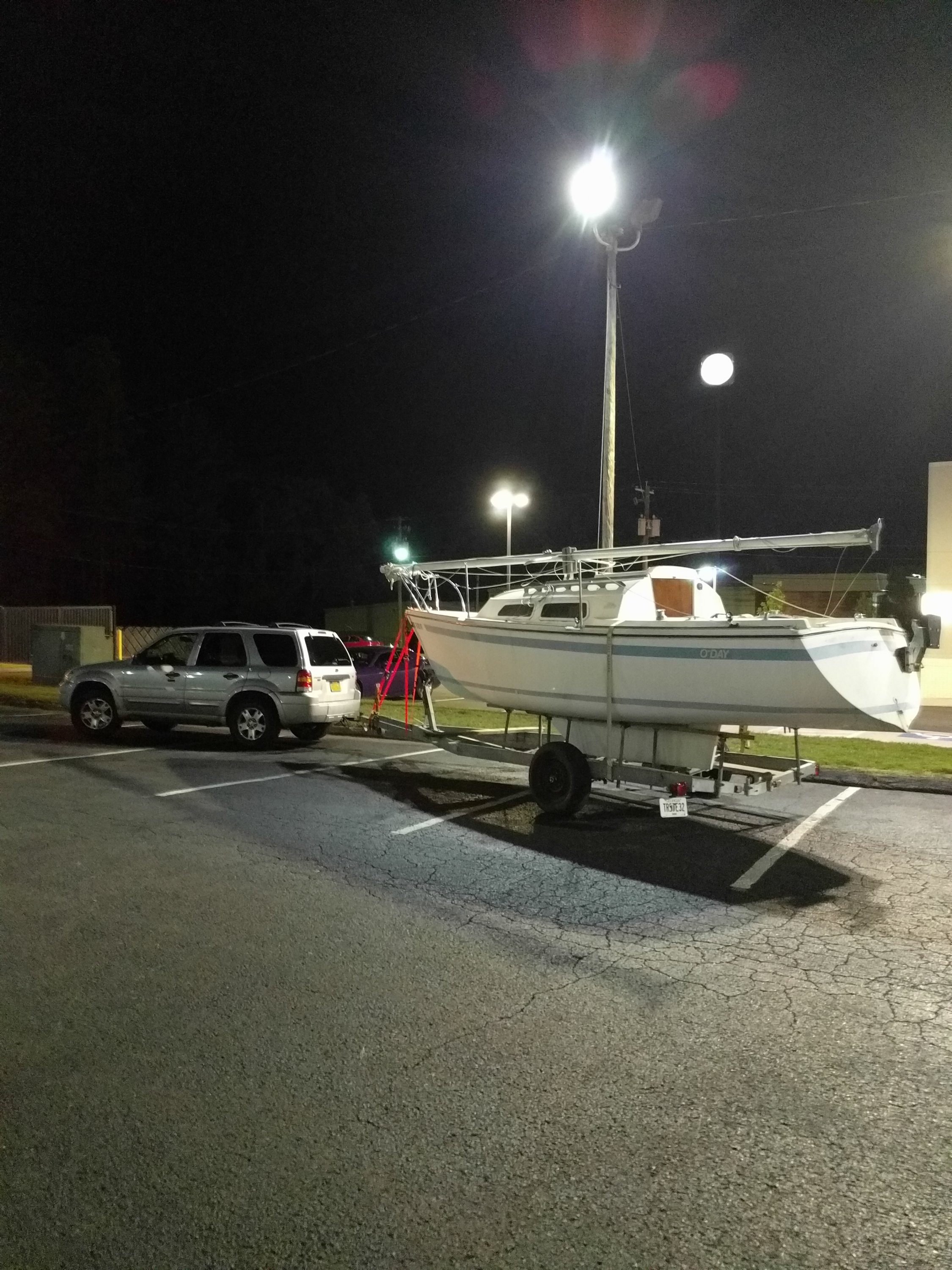

If I have 3 separate sources, Engine alternator, Solar Panel or 120v Charger, for supplying input to the Deep cycle battery do they need to be isolated in some way and manually switched from one to the other? Or other? The picture shows us on the way home from Georgia 5 hours after I bought her.

Nice looking rig. Get a copy of Don Caseys book on electrical although I prefer Calders book for everything else. Also read the manuals online for every charger you are looking at. Don't go any bigger than the boats wiring can handle. Ten to twenty amps should be fine.

Thanks Larry, She cost $900.00 to purchase plus traveling expenses. I got her on E-bay so I really couldn't inspect before I bought but even if she was a wreck I still got a trailer. I see Casey's book on Amazon and its in my Cart!
