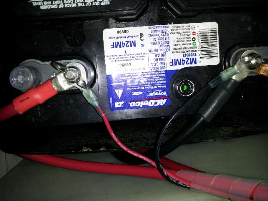

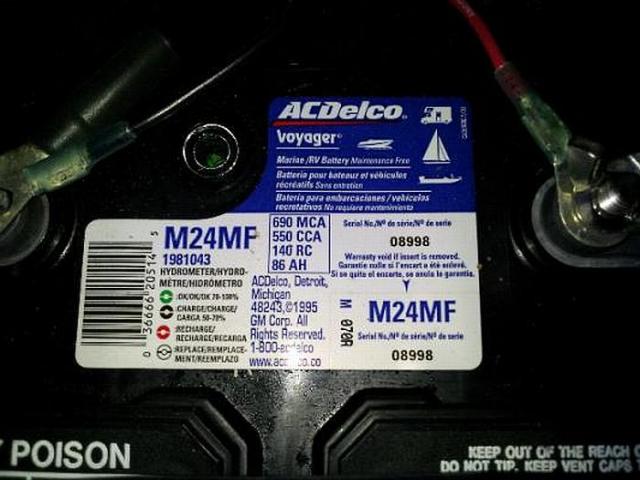

Just snapped these with my phone, not sure how clear they will turn out on the site, i am uploading them from my phone where i cannot even see the full size image on the post. if you cannot read the label on either let me know and i will post to my website and send link when i get home.

Here it is again and easier to read.
As posted there may be some doubt about how AC Delco measures AH. In any case any true deep cycle battery will not list a CCA rating as it doesn't apply to any but a starting battery. 86 AH is very large for a group 24. I downloaded the entire AC Delco catalog and I couldn't find how they measure it. If you look at a Trojan's specs for a given deep cycle battery they state clearly the 20 hour rate as well as a few others. They do not show CCA ratings on a deep cycle battery.
Although common on many batteries not specifically designed for marine use the wingnuts are frowned upon by ABYC as you cannot get enough torque on them when tightening.
