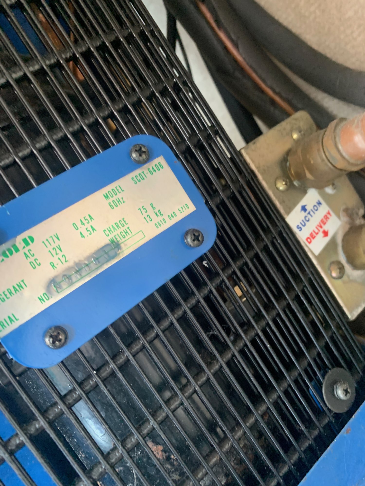

Last summer we purchased our 1985 37 ft. Hunter cutter SV Shadow.
It came with a Norcold SCQT-6406 refrigeration unit for the icebox.
I don't know if this was standard equipment on the 85's, but I'm glad to have it.
My problem is I don't know how to recharge it.
To start, the original refrigerant was R-12. R-12 is no longer made and has been replaced with R-134A.
I bought a can of R-134A and a delivery hose and attached it to the suction valve on the copper piping.
I opened the valve for 5 seconds, turned it off and waited 5 minutes to see if the icebox's cold plate got cold. It did not.
I repeated this procedure a number of times but no change. In fact, the can of refrigerant seemed pretty full when I finally gave up.
My current thinking is that I have to purge the system of it's existing refrigerant before I can charge it, but I have no idea how to do that or if that is the right thing to do.

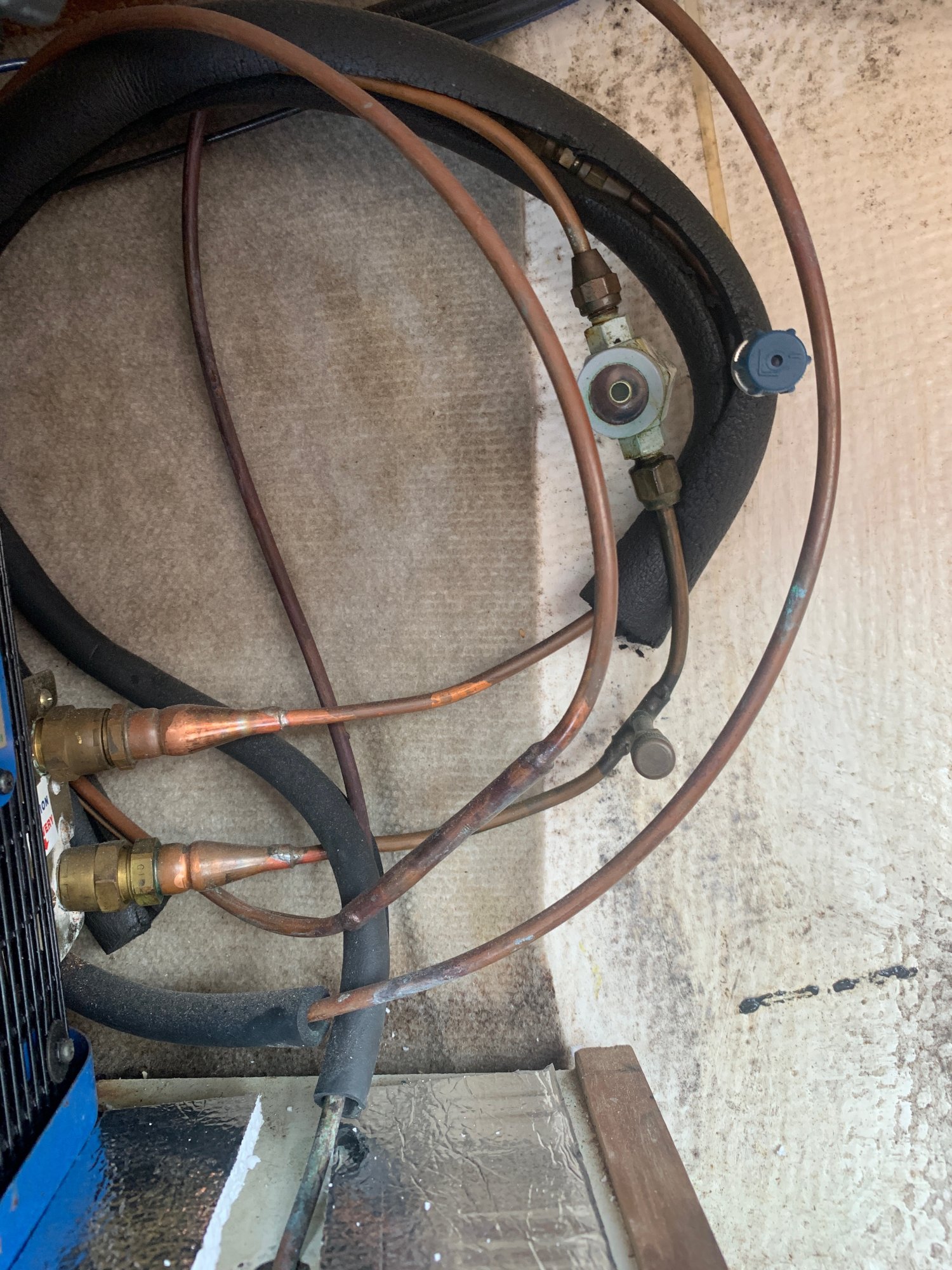

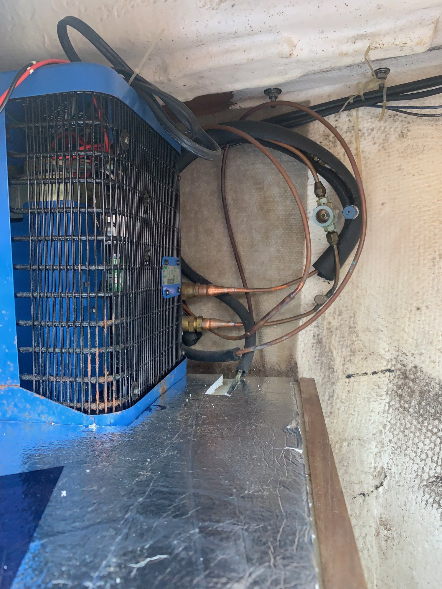

Attached are photos of the unit and it's valves.
Any advise will be appreciated. TIA

Not sure I undersand what you did here.
Did you use the fittings that were already installed or put some kind of conversion fitting to put in the R-134? It is my experience that the charge connection fittings for R-12 are different than the fittings for R-134. Are you sure the PO didn't do a conversion from R-12 to R-134 sometime in the past?
I don't think you can mix R-134 with R-12. Secondly, if you purge the system make sure you don't tell anyone, even us and certainly don't brag about how you purged the system. It is a violation subject to significant fines if you purge systems without the mandated recovery systems to capture the R-12 and not release it to the atmosphere.

80 percent of a/c or refrigeration problems are electrical. Before doing anything mechanical, all possible electrical faults should be eliminated.
What makes you think the system need a recharge? Without knowing that the system is low on freon, just adding more is not the answer. From your pictures it appears that there is a sight glass. When you turn on the system, does the compressor turn on? You should be able to feel it move when turned on and hear it hum if it's working. If it is working, do you see bubbles in the sight glass? Bubbles will indicate a possible loss of freon, an inexpensive gauge set would be be better still.

NEVER Assume it needs Refrigerant. R12 and R134A are NOT compatible because of the oil in the compressor. You could ever really remove the mineral oil and use PAG.
12/24 volt refrigeration was "new" in the early 80s if memory serves...
Please! Don't mess with it! Until you do this at least:
Start the system... listen for gurgling at the evaporator... let it run, if you do hear it running. let run a good hour or so. The Evap should slowly get cold, colder, very cold. The lines should not get frost.. the "frost line" should stop just a inch or two from the evap. Compressors get warm to hot. (normal)
The system was worked on by someone. The sight glass is really not needed. It's old school for large systems. The ports are called schrader valves. (like car tires but not the same thread.)
The reason people should not mess with miniature refrigeration is the the critical refrigerant charge. Just connecting a 3ft gauge hose will cause a loss of 3 oz or more. The only proper way is to weigh the charge in with an electronic scale that reads digital.
