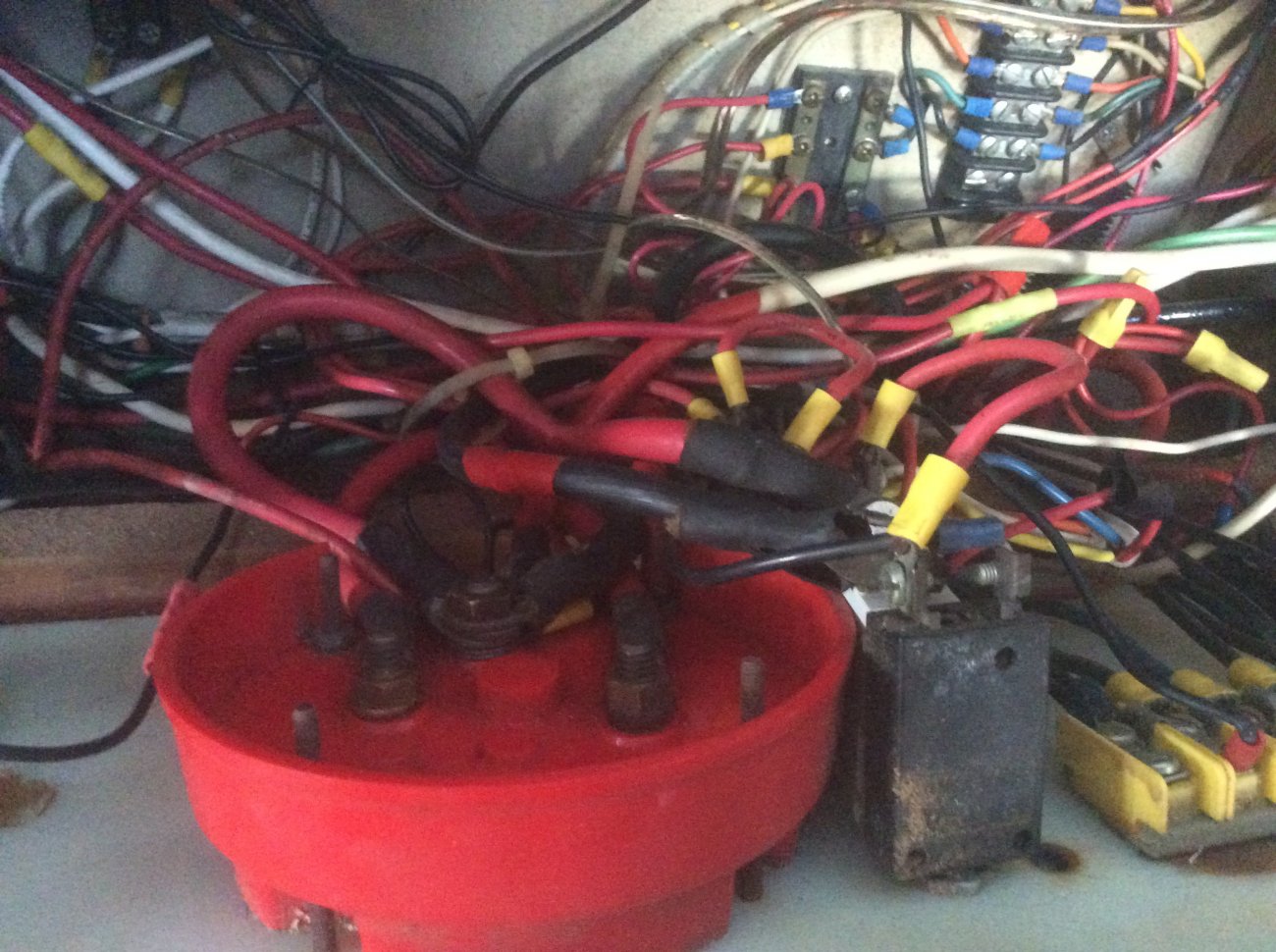

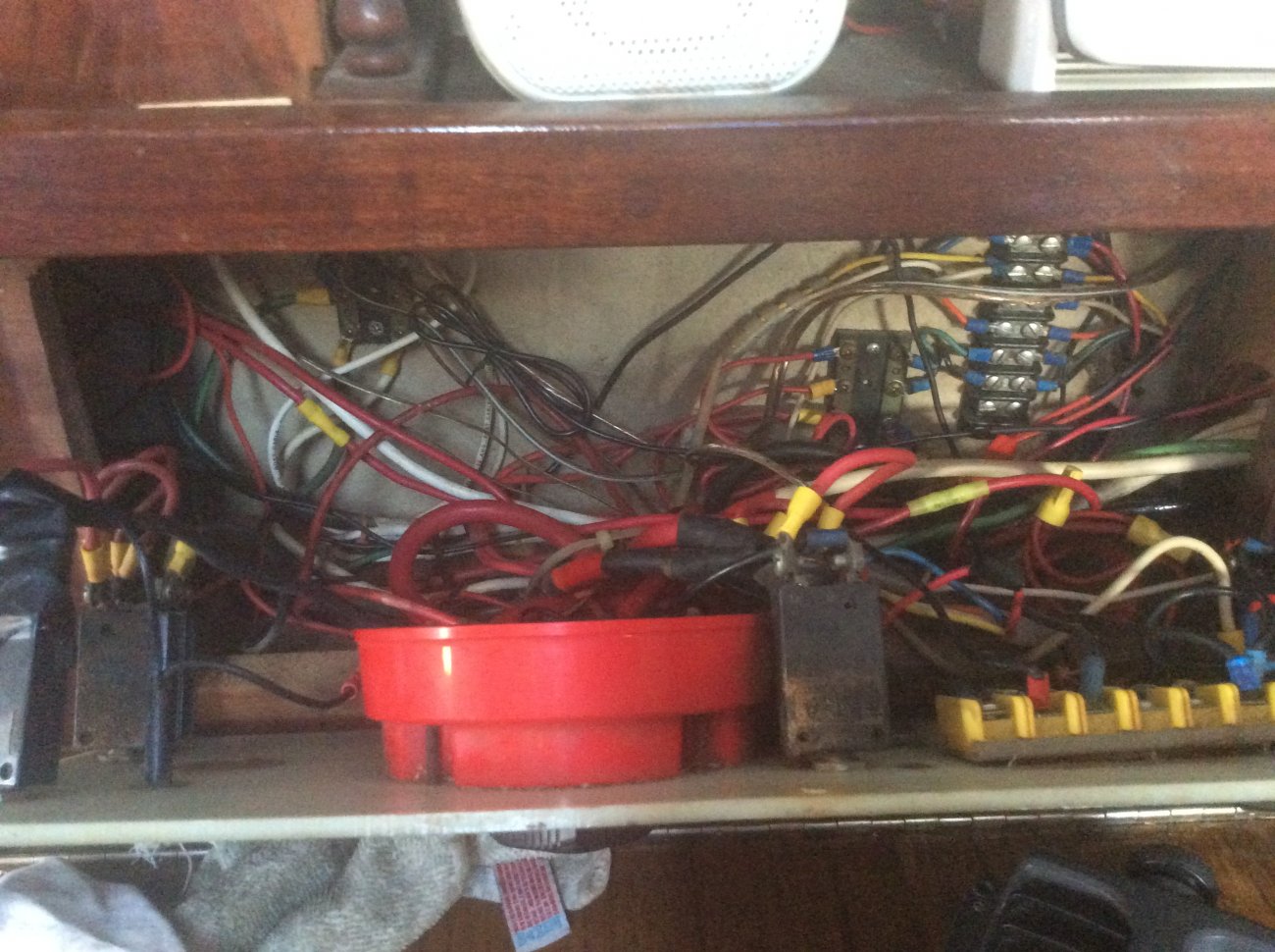

I should be at boat tomorrow. I'll get some pics. wiring here is bad as you can see. Sorting it all out. I'm just trying to find where the charge wire from engine ends up at the panel. Doesn't go to the switch. I came across some Cat 30 wiring diagrams that shows the charge wire #10 red going to the panel 20 amp breaker.. Each set of breakers fed from this. So I assume this might be the charge wire. It is a red #10. I'm getting a new panel and also have the Blue Sea combiner. All charging devices go to a common bus bar. Engine/solar/battery charger. This all then goes to the house. The combiner will take care of things then. Which is another question. Blue Sea says to have the exciter wire hooked to the combiner. Is this just a direct connection from the exciter wire to the ACR leaving it also connected to the alternator. I believe the exciter wire tells the ACR to combine during the start phase if needed. Am I correct on that. Getting things sorted out as this panel is in rough shape. Probably because its over 40 years old. This is a 1979. Same original breakers etc. I've added a pic of the back end so you can see the mess. Definitely needs an upgrade for sure. Breakers are in really poor shape. Plus the AC side is worse. I've very familiar with circuit tracing and finding stuff but for some reason not yet known I can't seem to find this one wire.

No, just the opposite. The ACR combines two banks for charging based on voltage parameters. The SI version of the ACR stands for Start Interruption. If the ACR is in the combine setting/position and the SI sees voltage the ACR disconnects the two battery banks so both banks are not connected for charging. The SI wire can be connected to the exciter wire or any connection which sees voltage during when starting the boat. I have mine connected to the starter side of the start button.
It sounds like you talking about the DC Distribution panel. If so, there is a good chance it goes to the positive bus bar. Most likely it goes to the hot side of the starter solenoid. The charge current is then carried back to the DC. Distribution panel by the starter cable which is attached to the C post of the battery switch.

Thanks Ward. Sounds like I'm getting things sorted out on this end. Our boat Is in Mexico where it is kept and some Blue Sea stuff can't be shipped here where other Blue Sea things can be. So this leads me to finding other sources for the things I'm after.
I agree with you here on this. I've looked it over a lot and this seems to be where it ends up. Just need to find that termination point so I can have the charging wires on a central bus bar. then I can take it to the distribution panel.
