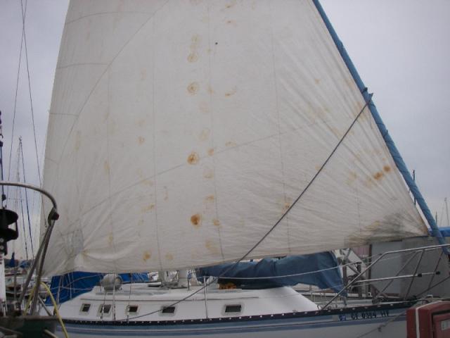

I have long been intrigued by the picture showing an HC37 sailing beautifully in glassy water conditions. I have been the lucky recipient of a cosmetically challenged but usable genoa, shown in the second picture. So far I have only raised it in the dock, among other things I need longer sheets in order to try it out. I now have them and if conditions are suitable will try it out this weekend.
I intend to use it “unhanked”, attached only at the head, tack and clew and with the Yankee in place. I have a quick release on the inner forestay and will experiment with moving it out of the way.
I have no intention of replacing or modifying any of the existing rig – it works very well for me in the variety of conditions on San Francisco Bay.
