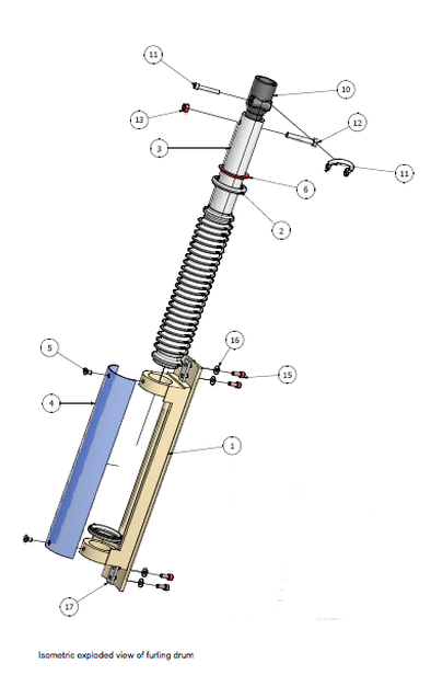

To furl the main sail, there is a line that goes around a drum in the mast. That drum is roughly located at boom height inside the mast. When you pull the out-haul line the sail unwinds from the foil and the in-haul line winds onto the drum in the mast. To furl the sail you pull on the in-haul line which turns the drum in the mast and furls the main sail onto the foil. I have attached a drawing of the mechanism that lives inside the mast.

Definitely not a Selden as Selden doesn't have a drum as your diagram shows. I have seen the arrangement which you show on several boats near me and it may be a US Spars as seadaddler suggests.
