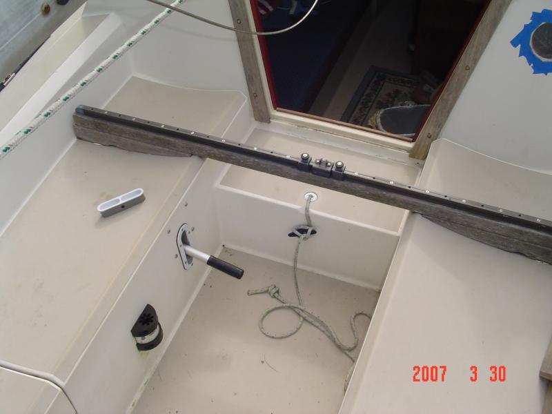

I put in a little longer track when I installed my new traveler. It wasn't that bad.

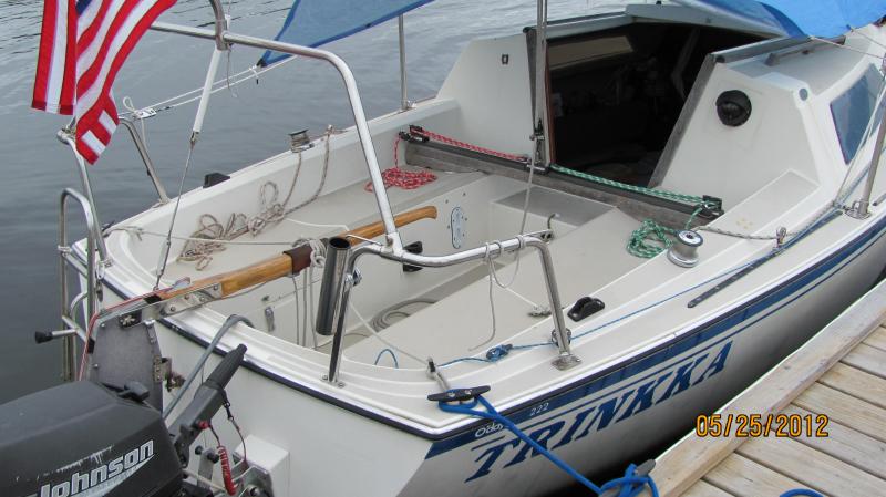

I have an '80 Oday 25. I recently discovered that the inboard sidewall of the port quarter berth is a swing down panel that gives access to under the cockpit, opposite of the lazerette. That should give good access to the underside of the traveller if you have the same panel.
