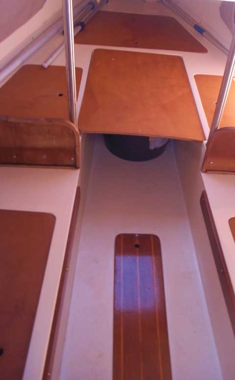

As for the post mod?
The 18 and 22 are pretty similar. The "posts" are 1" diameter Stainless Steel tubes with flanges bolted both ends.
The top flange is special - but the bottom one is a simple flat flange-thing.
The flanges have four screws into the glass.
The bottom flange sits on the edge of the V berth.
That edge has a pair of vertical surfaces for support and could be stiffened with a block glued in the corner
if the post had to be offset away from the edge for some reason.
This picture looks lit a 18. The 22's V bunk is a LOT longer...
98
Catalina Capri-18 Dallas TX
See, if you draw an imaginary line straight up from the mast bridge on the cabin floor,
you come to the aft corner of the V-Berth.
Looks like everything is in the right place.
