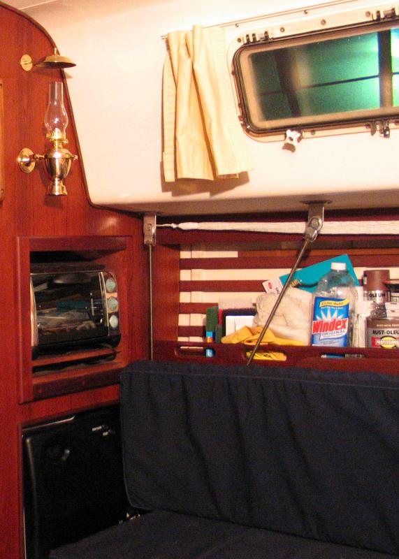

I better explain this in more detail, where the chainplates go through the deck they look like the standard flat SS bar that extends a short distance into the cabin, then the round rod attaches and continues down behind the seatback.

I have an 82 Hunter 30 with chain plates that sound like your description. photo is attached, showing the cabin interior.

I just looked at your photo. The rods are the same as in my 82 Hunter 30 (see photo above). Actually there are three rods. The third rod can be seen in the hanging locker.
