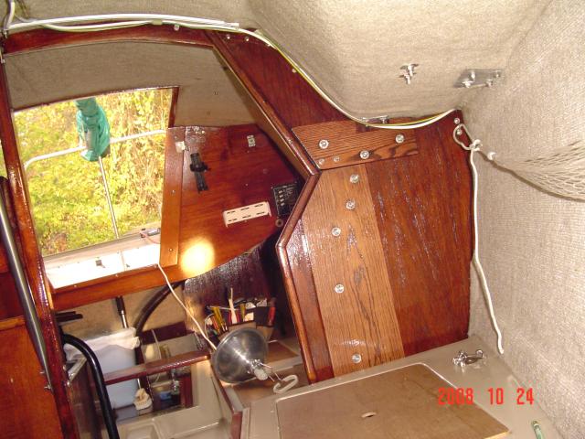

Jimmy,
Here's some pics of how I beefed up my bulkhead. I think that with the chain plates that you're getting from Rudy and some good "L" brackets, you should be all set. Always stay with the same 1/8" shroud thickness and you shouldn't have a problem.
Joe

I checked out those Catalina eye bolt type chain plates and I'm leery of them only because they need more reinforcement inside the cabin. A strut or an "L" type bracket needs to be attached to them as well something solid inside the cabin such as a bulkhead. When one of my old "L" brackets cracked inside the cabin, the surface under my chain plate was starting to bulge. I never really caught it at the time. I took my boat to Rudy at D&R Marine, and his business partner at the time, went into the cabin and found it and pointed it out to me. This prompted me to change my chain plates over to the flat bar type plate commonly used on O'Day 25s.
Joe
