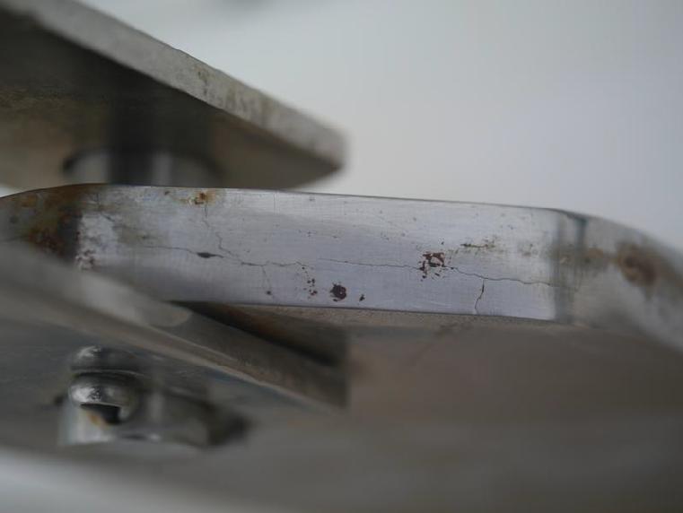

Hello everyone,
Hoping someone could give me some advice on chain plates. It's a 2000 Hunter 410. During inspection Rigger noted pretty serious cracks in both chain plates. He says "could last 4 years or 4 hours". Hunter says plates are not available through them, considering fabrication. Requesting your experience please.

I'm familiar with the chainplate setup on our P42, which remains in good condition, but not the 410. Some photos of your arrangement and the cracks would help here.

Your rigger is giving you good info. Pitting in chainplates can be buffed to remove the signs of SS rusting. But cracks are the like boards splitting in your roof rafters. If there is no strain they may last for awhile. Take the boat out into 30-40 knot winds and the result may be like throwing a 7 instead of your point. All gone. Take this seriously. If you are not sure get a second opinion.
How about pictures. Worth a thousand words.

Definitely replace. That just looks like a rig failure waiting to happen. My experience has been that stainless corrodes from the inside out. Don't take a chance on losing your entire rig and endangering yourself and crew.
