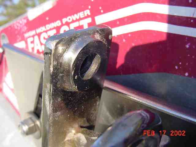

Check your chain plates, thats pretty simple. The aft lowers on my h37c looked fine 6 months ago at survey. then we broke one. careful examination of the lower made the problem clear. the aft chain plates are mounted strait up and down. but the load on the chainplate is not vertical in line with the chain plate. this caused the chain plate to bend and finally break. I have replaced mine with a new chainplate and changed the angle of the chainplate so as to line up with the load. We moved the bottom end of the plate outboard about 2 inches or so and redrilled and mounted the chainplate. All of the damage was hidden in the core one could not see the damage unless the plate was removed. So given that my boat an 84 is newer than most of the 37c,s out there i suggest everyone should look at these plates. The surveyor did not catch it and neither did I.
