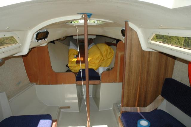

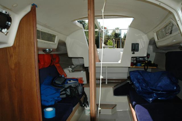

I replaced bulkheads on our 1985 oday 23. Its a tedious but not too difficult job. You need to know your way around all sorts of tools and it helps to have a friend around to help. Basically one day to remove bulkheads. one day to make templates and cut new BH"s, and one day to install. Of course this actually translated into two weeks of work with a few hours here and there.
Try to get 1/2 inch teak marine plywood, pricey ($200 or so, but worth the cost)
If the boat in in good shape otherwise and the right (cheap) price I'd not be intimidated by BH Replacement...
