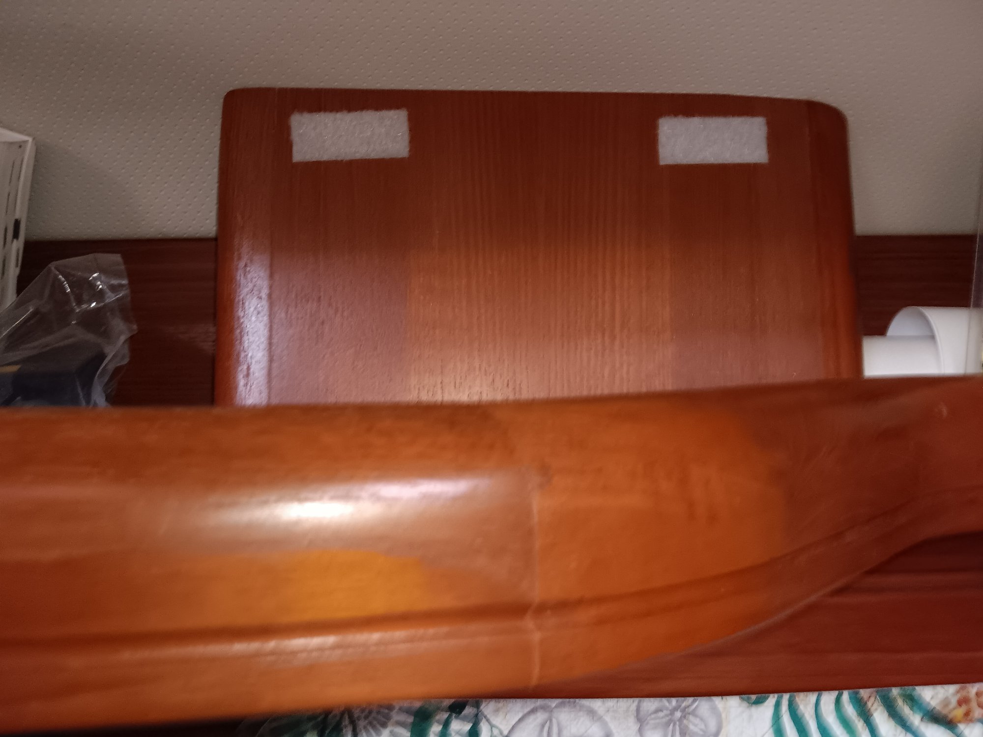

I want to inspect the chain plates from the interior on my 45cc. Does anyone know how to remove the wood fascia cover protecting the bolts and nuts?

Those look the same as the fascia covers on my 44 (which is also the same hull). Put a plastic scraper (or something that won't damage the wood) in the seam at the back. Jiggle and carefully pry with the scraper and the cover should come off.
