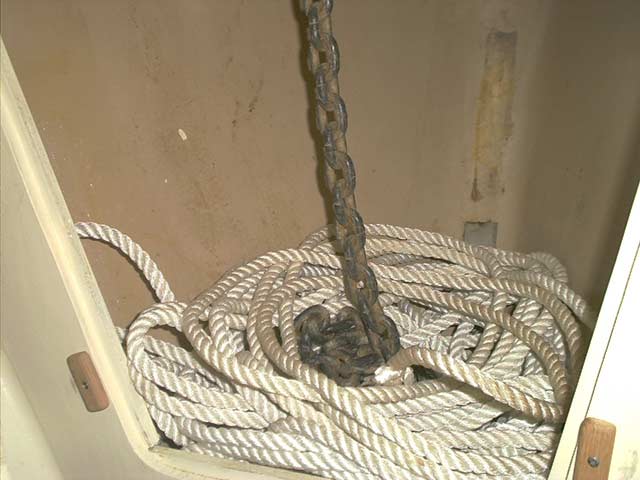

2,182
One additional point since you don't have anything installed. If you use a rope to chain splice instead of a thimble you don't need nearly as large a deck pipe. Mine is just a 2 inch round one.

Thanks, TSBB2
I'll consider the smaller pipe. I'm looking at a chain splice over a smaller thimble, too.
By the way, your pic was a great help!

Skip the thimble- just do the back splice in the last chain link.. Many years and close to 10,00 miles of cruising using that method. Zero chafe. I do inspect often, and renew the splice every year or so.
