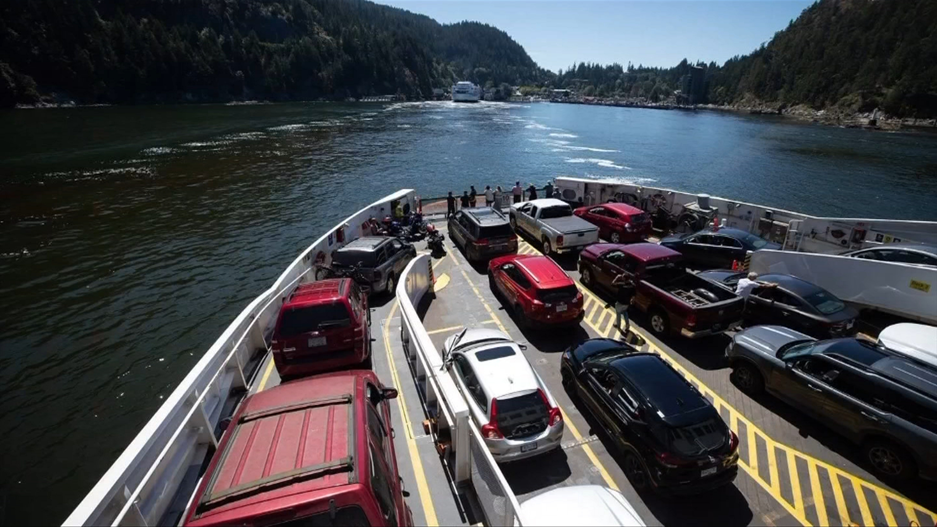

Speaking of lithium batteries (ion or whatever have you) brings us to EVs. And you may not want to own an EV here in British Columbia (BC) if you live on one of our coastal islands. All of the coastal islands here are served by our provincial government BC Ferries and they recently had an EV catch fire on one of their ships and of course it was a bitch to extinguish.
With that little excursion under their belt, they have now excluded from boarding their ferries, any EV that is not in pristine condition. The island dwellers own a very high % of the EV's in BC because they are tree huggers and rather wealthy to boot. The outcome now is that if you have an EV and it craps out on a BC island without a high tech auto service shop (and none of them do), it's pretty much scrap metal as the cost of barging it to a repair facility is prohibitive.
BC Ferries does have select days for moving explosives, liquified petroleum gasses, gasoline, and every other dangerous goods imaginable, but no damaged EVs.
It was a good idea while it lasted but hit a few snags along the way. BC produces 80% of its power from hydroelectric dams so its a perfect match for EVs. Unless you live on an island.
Talk about thread drift :yikes: .

How do they determine that? Particularly since the condition of the exterior or interior has little relationship to the condition of the battery system. A pristine new EV could have run over something and dented/punctured the battery, or knocked a wire into a short circuit, on the way from the dealership to the ferry.
A better idea might be to let non-EV's on first, then put down a gate connected to a hydraulic ram, then load the EV's. If an EV catches fire, the ram pushes the gate and all the EV's dump off the ferry into the water.
