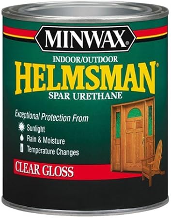

If the Cetol experiment doesn't pan out, I can recommend the product below. You can find it at any big box or neighborhood hardware.... or Amazon. I found this after a number of years using Cetol back when it was ORANGE. I guess it's improved, but I ain't going back to the stuff since Helmsman is about 1/3 the price. A quart will go a long, long way on a C25's limited brightwork. It comes in gloss, semi gloss and satin. It is as easy or easier to apply than Cetol.
