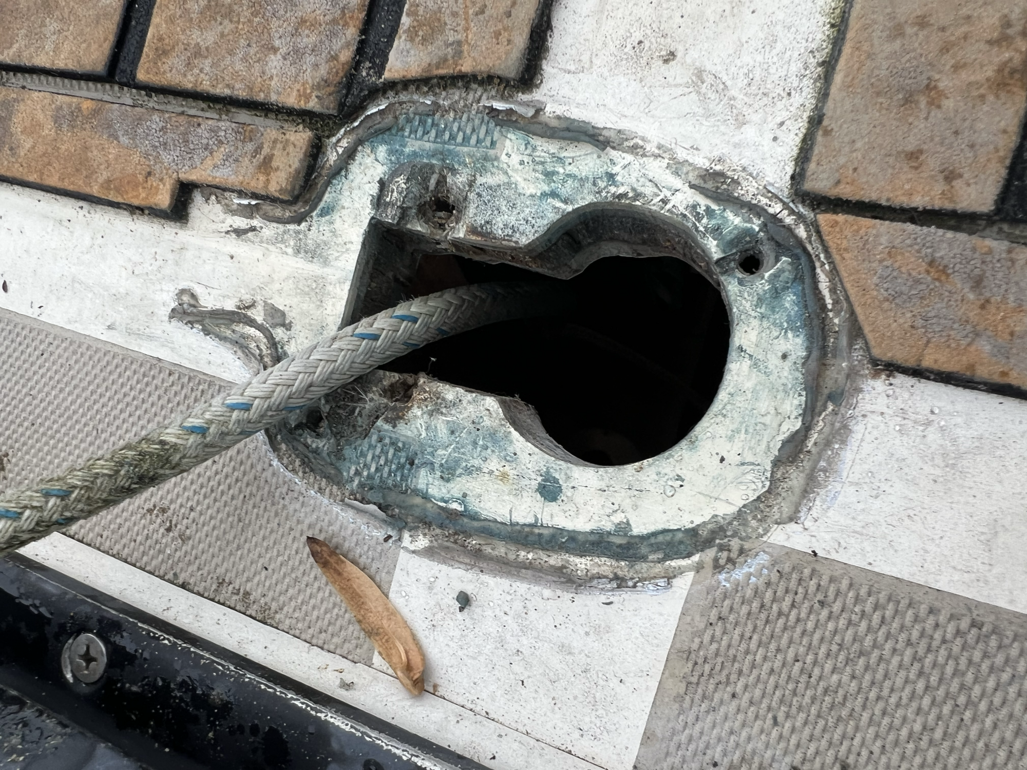

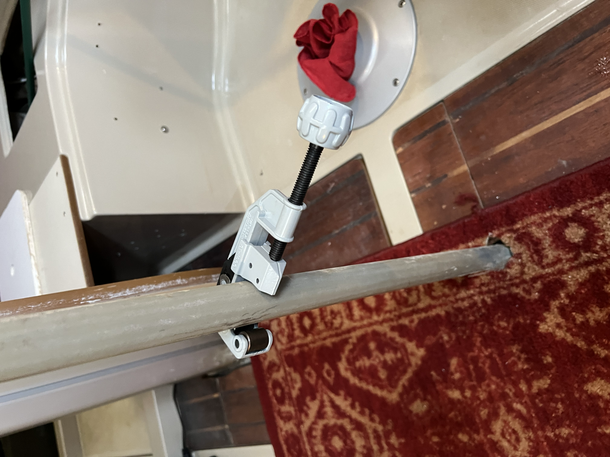

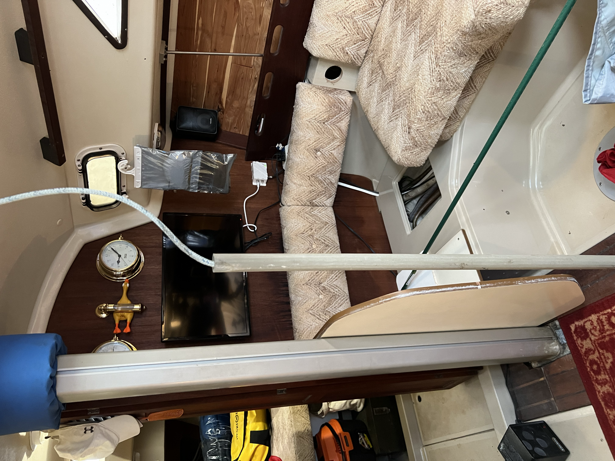

Although at the beginning of the season I was able to splash with a working centerboard, I ended the season with it stuck again and my uphaul line snapping. I ran aground in the Chesapeake Bay, into soft mud, which I think has clogged the opening inside the keel where the centerboard sits. So today, my friend and I were discussing how to tackle this, and brainstormed how to access without hauling out again. (Big bucks). We stared at the pole that holds the uphaul, inside the cabin for a while and then looked into the bilge where the pole is attached. I felt around the base of the pole, thinking it had been inserted and sealed closed. But actually the opposite. There was a lip. So we removed the top cap and the sheave holder and the pole lifted out. Inside that pole is a PVC pipe, about 40" tall, that is sealed into the bilge. Still cannot see the end of the line and the wire connection, but I think a long wooden dowel should be able to be inserted to push the Centerboard down. Going to work on that next week. Will circle back to all and let you know the outcome. I write this to help others that might have the same set up and challenge. Once its down, a new line attached, and all put back, going to figure out some way to put a stop on the uphaul to avoid getting the centerboard stuck again. Maybe the conversion point of wire to rope is the issue, could be a sticking point. No pun intended!

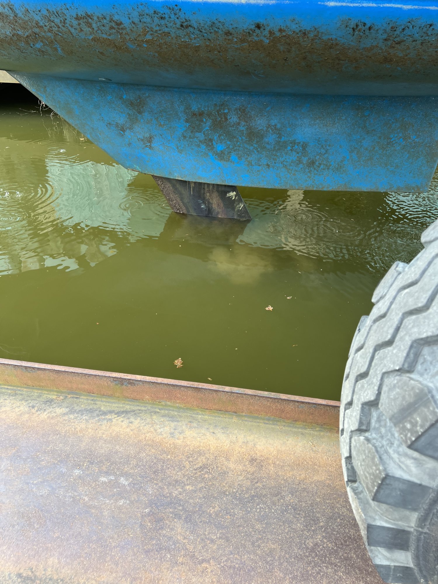

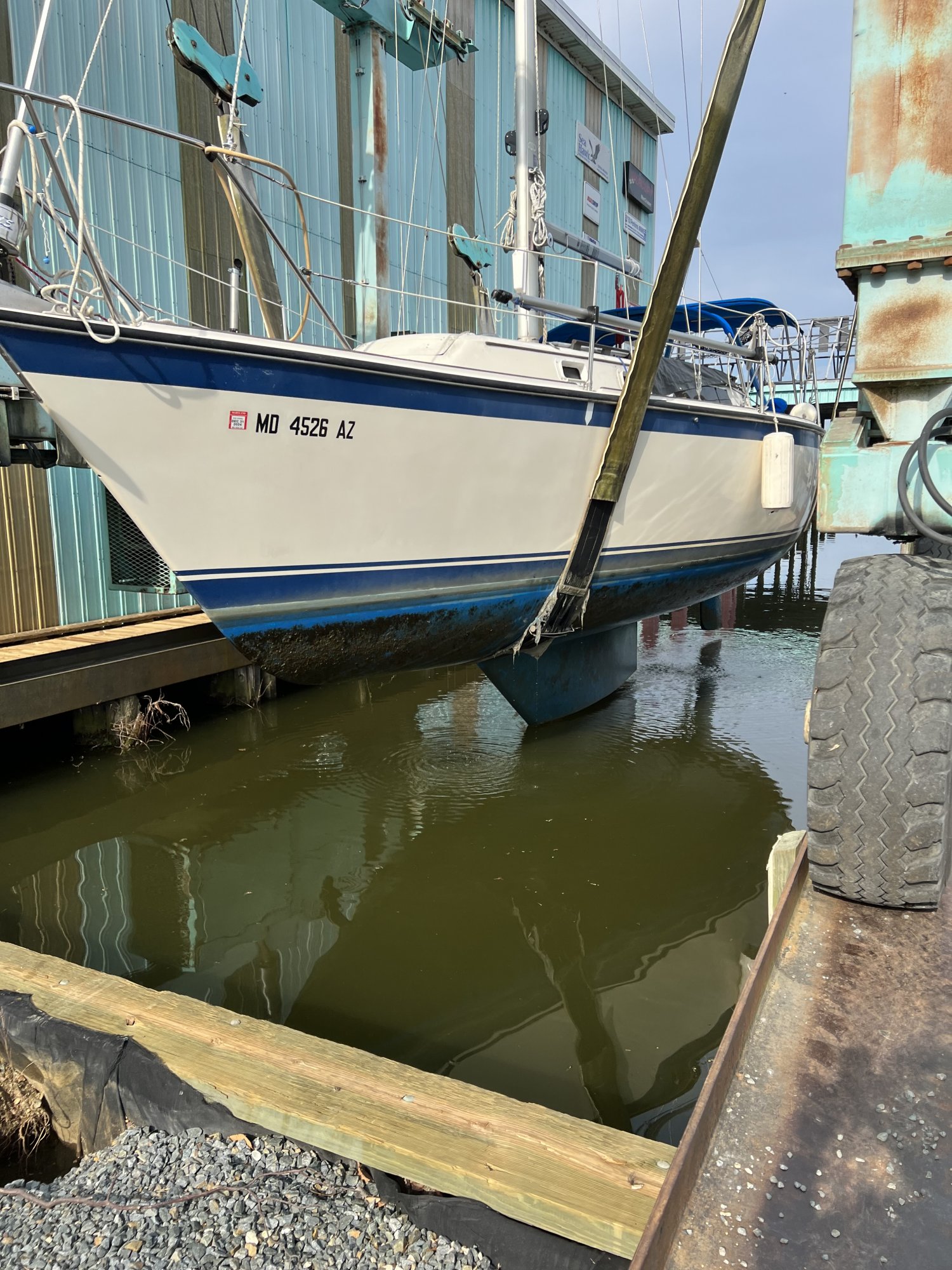

Boat is in the water. Once I get my fresh lines back from the rigger and they are reinstalled, everything put back together, the boat will get a short haul. While in the slings I will power wash the mud out and the board should drop. I wanted to avoid the short haul due to costs.

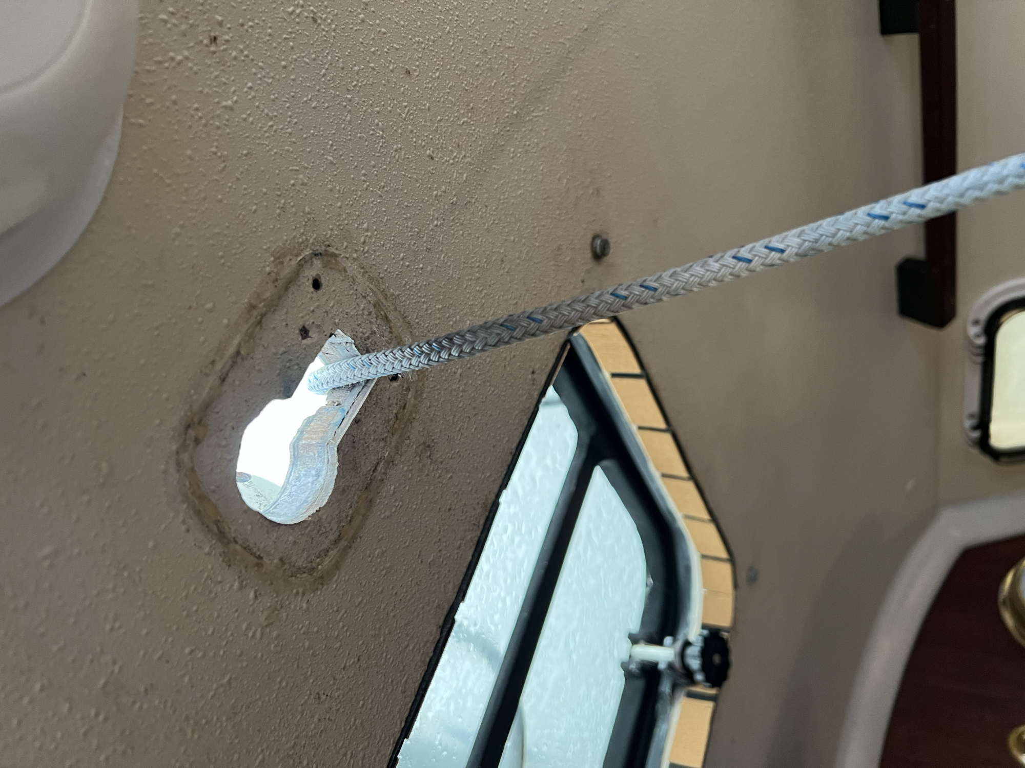

As a wrap up to this saga, (I hope) here is what I accomplished. I re installed new lines for the up haul, along with replacing the inner and outer tubing that runs through the cabin. With this all set, the yard hauled the boat. As the boat came out of the water, some of the mud was released and the centerboard, having loosened the up haul, dropped. Once out of the water the cavity was thoroughly power washed out, the bottom got a wash down. I took the opportunity to inspect the hull for any damage and to make sure the anodes were in good shape. Back into the water. Lessons learned: Pay more attention when in shallow waters. On the bright side, I can claim, I've sailed in the Chesapeake, because I have run aground. Not without great expense!!!!!
