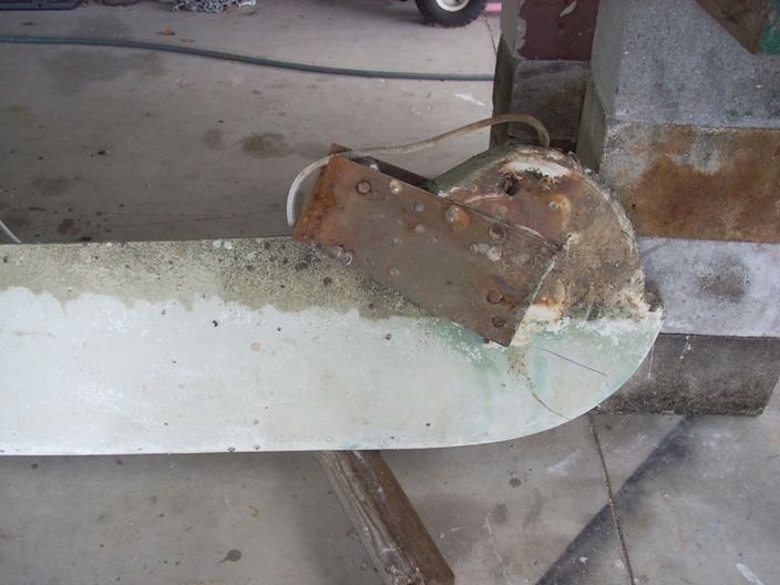

Did ours last season and it was much easier than I'd have thought but I don't remember the specific size. Take a piece of the line with you to your local WM and make sure that you buy the highest quality line with the lowest stretch specs available. Buy a few extra feet to allow for knots and errors. The last 2-3' of the line at the CB head will always be submerged when the boat is in the water.
If there's one trick to getting the CB bracket back into place it'd be to get a 24" piece of 3/4" all thread and use it to easily align the bracket bolt back into the hole.
