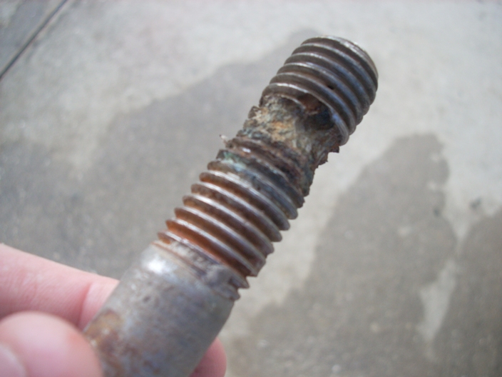

My CB bolt was shockingly corroded so you might have a spare ready(see pic). I used 5200 to re-seal the bolt head. I know, some think it's equal to epoxy but that's ridiculous. Simply put some heat on 5200(hair dryer or heat gun) and it becomes putty. Oh, and don't forget to tie your new line onto your old one very carefully so it can act as the guide over the upper roller and down through the compression post.
